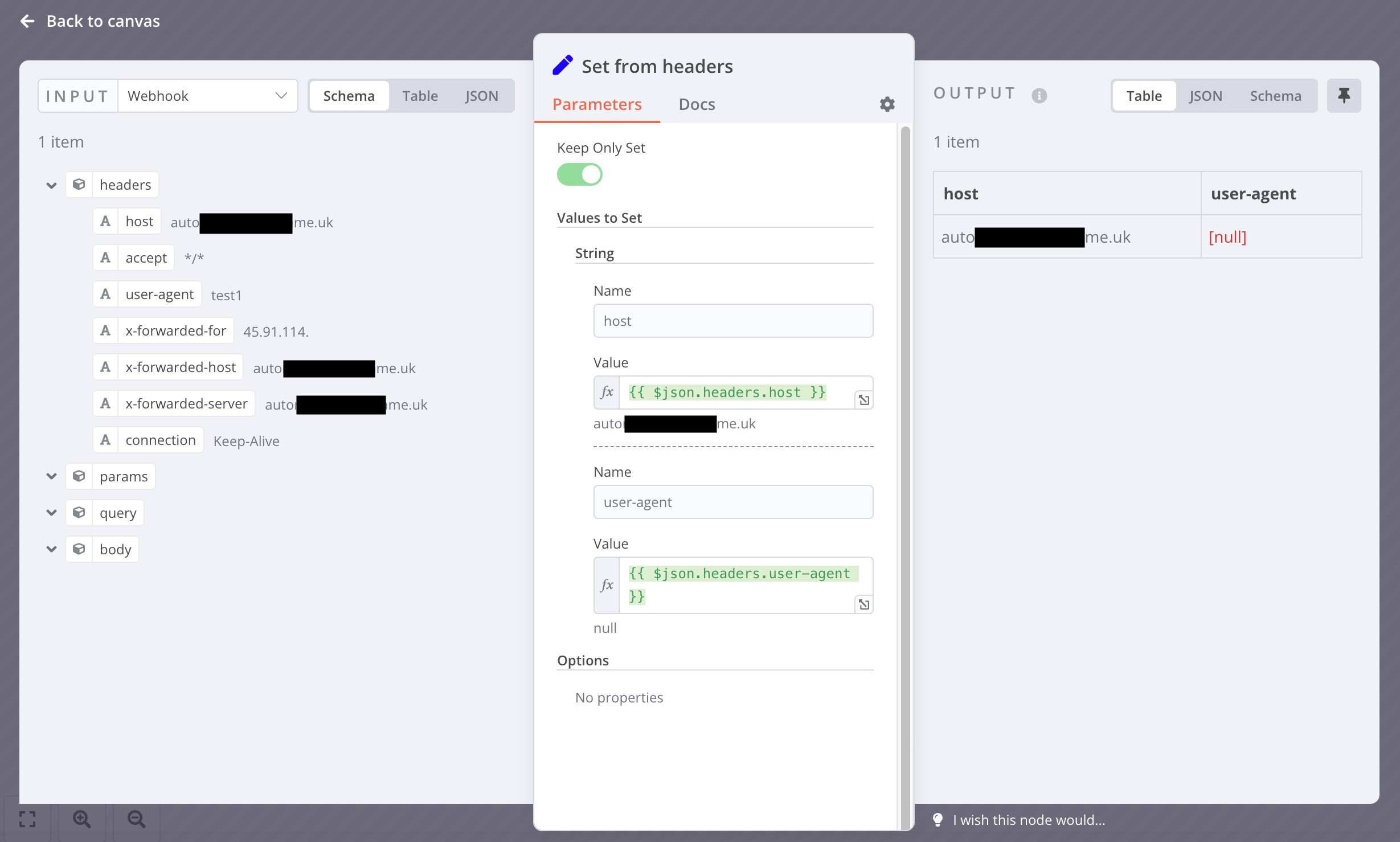

I am not able to access Webhook HTTP header fields from from within a Set node, but only if the header field name contains a hyphen.
i.e. from within the Set node, {{ $json.headers.host }} returns a value, but {{ $json.headers.user-agent }} returns null.
What am I doing wrong here? Thanks in advance.
Test data
curl -v -H “User-Agent: test1” “https://example.com/mywebhook
will return:
{“host”:“example.com”,“user-agent”:null}
Here’s the execution on my hosted server:
Information on my n8n setup

Hi @surbitron,
Was your user-agent expression created by n8n UI with drag&drop? Or did you type it manually?
Since there is hyphen (“-”) in object key, you can only get it’s value with {{ $json.headers['user-agent'] }}
I hope it helps.
