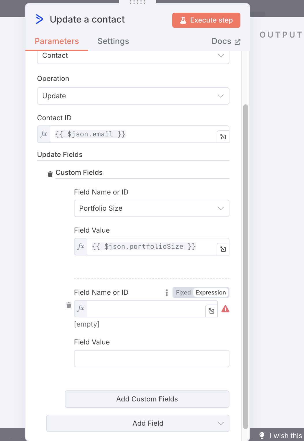

I have a simple workflow set up with 3 nodes webhook->code-> Active campaign (update a contact)
In the active campaign node under the update fields section the custom fields are not all flowing through from Active campaign. some are, however most of them that I need are not.
There is no error message, more that the option is not there at all. When I try to enter the custom fields as a a expression instead of fixed an error message pops up of " the value “Investment Experience” is not supported!" However I know that is exactly how it looks sitting in my active campaign

Hi Darell, the video is just a recording of the options that show up when I try to add the fields that I want updated. There are quite a few (maybe 30) but not all of the ones that are present in the active campaign account. Let me know if you need any more info from me on this.
Looking at the recording it has 100 fields on it. Is there a way to push past the 100 fields so I can have more as the fields I am after are not in those 100 fields. Or is there a way to configure it within active campaign so that the fields I want sit higher up the list and therefore come through on the list within n8n?
