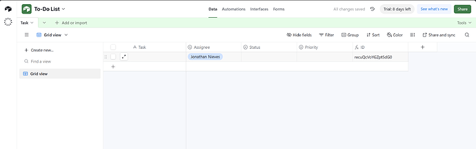

It created a task but its completely blank and the only think that received is the Assignee

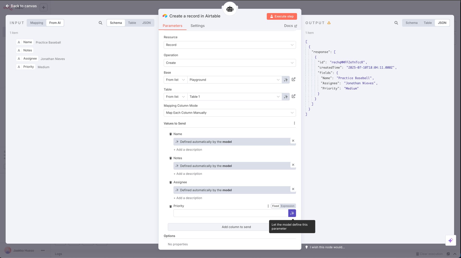

I set the Create record node no set fixed values when creating a record. And it created the record with no task name. So, the problem must be between the AI node and the Create Record node. I’m pretty sure is because the Create record node can’t map the values because for some reason the AI node is not sending them. Shi…

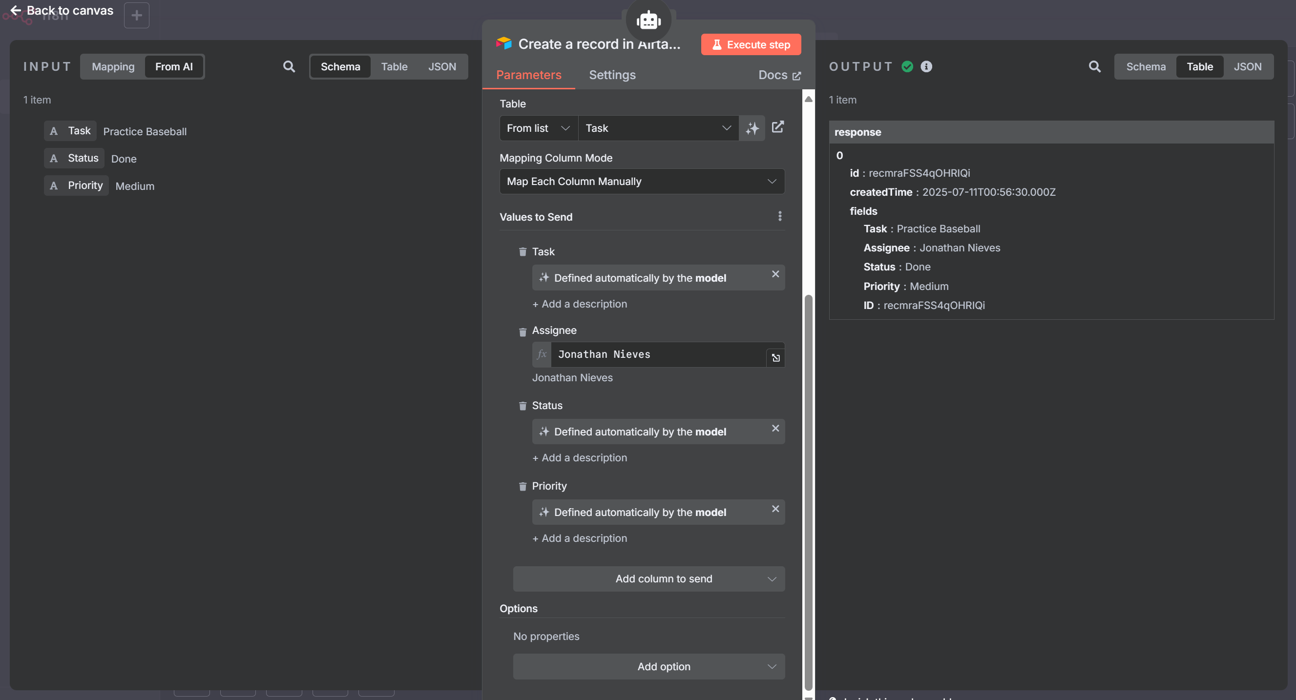

Hey @jotyrojo,
Instead of manually trying to map the values to send you should try enable the “Let the model define this parameter” option on those fields you’re trying to set, at least I was able to get this working against my airtable!
Finally! That seems to work… Thanks @Jaakko.
I notice that in the create record node when the field in the Airtable is set to single select then the node doesn’t let the AI choose between the option and you have to configure it to select only one of the singles select options. What I did was change the Airtable fields to single line text and let the AI define automatically the text in the output. Thats a shame because now the fields are not colored depending in which field option you choose, but at least it works for now:
