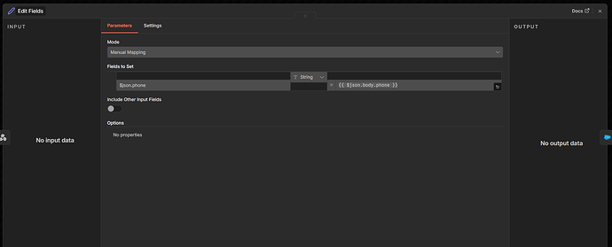

@mroncetwice
In the Edit Fields node, you are currently using: {{ $json.body.phone }}
However, the actual input of this node does not contain body.phone, so this expression never resolves.
Step 1: Inspect the Webhook input
Execute only the Webhook node and check the real JSON payload it receives.

Step 2: Correct the Edit Fields node
In Edit Fields, create a flat, deterministic field:
Field name
phone
Value (expression)
Use the correct path based on the Webhook payload:
{{ $json.phone }}
or
{{ $json.data.phone }}
After this:
  • Do not use body.phone
  • Do not use nested paths downstream
  • From this point forward, always reference:
{{ $json.phone }}
So
Once the phone value is fixed upstream:
  • The Salesforce Get Many Leads node should filter using {{ $json.phone }}
  • Add an IF node to check if a Lead was found
  • Move the AI Agent to the very last step
  • The AI Agent must only format the final response using already-resolved data
The AI Agent should never:
  • Resolve expressions
  • Decide whether a Lead exists
  • Reference {{ $json.body.phone }} or call Salesforce indirectly
Thanks, @tamy.santos. You have definitely helped me make a breakthrough in my progress.
The phone field in the webhook output looks like this:
"headers": {
...yada yada...
"params": {
"query": {
"body": {
"phone": "+13456789999"
Trying {{ json.phone }} in the Edit node returns a null value when executing the step, whereas {{ $json.body.phone }} correctly returns the phone number entered in the HTML form.
But you were on the money with the Get Lead node— changing the Condition Value to {{ $json.phone }} correctly returns data for the Lead that has the submitted phone number.
