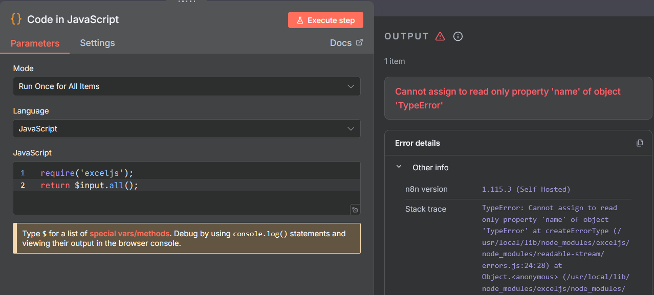

All the npm packages can be found inside the image that gets created, but when I go into n8n, a few of them don’t work as I expect them. For example if I call the mongodb package it works fine.
But if I call exceljs it returns an error.

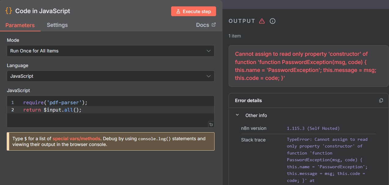

It is clear that the npm package gets recognized, because you can see it in the stack trace. Another type of error I get is with pdf-parser.
When I tried these same packages in a normal js file outside of n8n, they ran fine.
So my question would be if there is something that defines what npm packages can be added to n8n? Is there a workaround to adding these packages?
