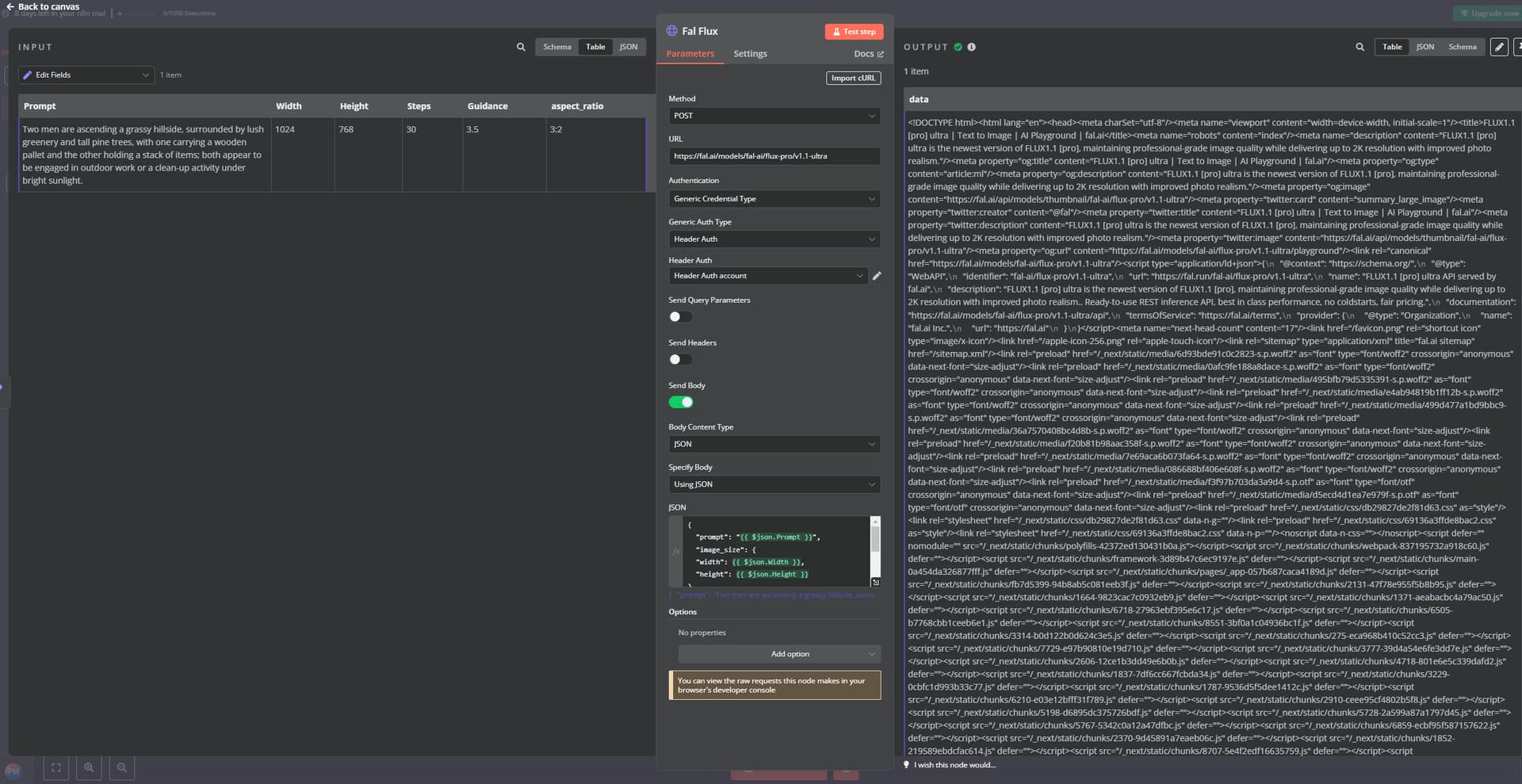

WOW! it works shapr!! :slight_smile: Thank you, you are genius :slight_smile: Now I have another problem :smiley: I attached a screenshot with data. But as you can see on output they are somehow messy. I need them to be strusctured as at left side at output. Next step reads {{ $json.request_id }} if process is done. If yes it continues if not it start all over again
Can’t say why it returns data as HTML. You can save the output into file and open it with a browser to see how it looks
I figured it out, it was just a wrong url :slight_smile: Thanks a lot.
