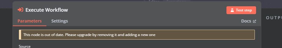

That’s the odd thing; I wasn’t getting any errors when running the workflow as far as I could tell. I’m new to this, so it’s possible there was something in a log somewhere that I’m just to daft to have seen. :slight_smile: The symptoms I did see is that:
  1. When testing the workflow I’d see the little green checkboxes in the nodes in the main workflow, but never any in the sub workflow.
  2. No files would ever be created in the GitHub repo.
The only error I did see was some “node is out of date” errors. I tried testing the workflow “as is” with the out of date nodes, then re-tried after following the instructions to remove the out of date nodes and re-add new ones. Still no luck.
