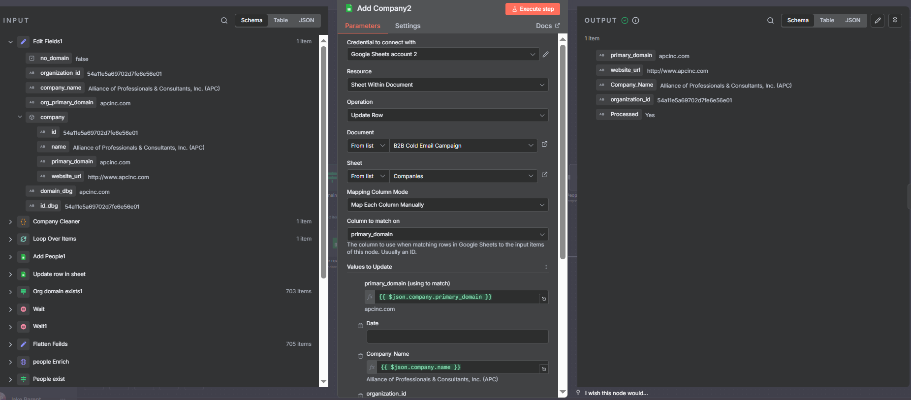

Everything seems to process fine. It simply does not update my sheets (My update google sheets node I added below). I’ve tried everything I can think of. Tried making a new sheet, making a new tab in the sheet, changing some values to see if it’s just that row. The most interesting Is I have another flow that is EXACTLY the same except it is for a different data base, but all other factors are equal. I even tried hard coding it. I’m at a loss. I also updated my N8N since I self host, which for whatever reason got rid of the non-json header option for HTTP request but that’s a problem for a different post.
No error.
So not the last node, it’s this “Add Company2” node. I see it outputs the correct data. I attached a screenshot below of the output and of the not updated sheets. However my rows never get updated with “Yes” in the processed column…

Hey, so if I understood correctly, you have another one working that updates a different sheet with the same credentials, correct?
Have you already tried building a new separate workflow from scratch, and testing 2 nodes inside:
  1. Node updating the other sheet that normally works
  2. Node updating the affected sheet
This way we can understand if this is affecting a sheet or the entire workflow becomes somehow corrupted.

Thank you for your reply. I’m testing a solution that there’s some duplicates in my sheets and I think It can’t find the correct person since there’s multiple. I’m trying to do a dedupe flow using the google sheets api, was working but after I updated or maybe google updated I get an error saying i’m not authorized.
I have tried both those unfortunately.
