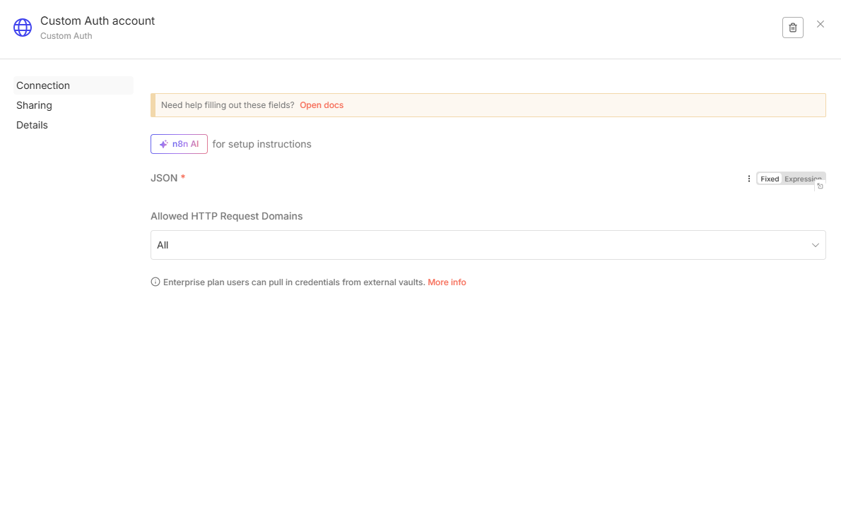

[Bug Report] The httpCustomAuth credential crashes when updated via API

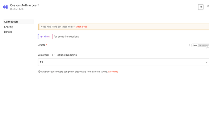

When updating a Custom Auth credential using the PATCH method via API. When you visit the credential in UI it shows that it was updated “Just now”, but doesn’t have the JSON box anymore (see picture).
