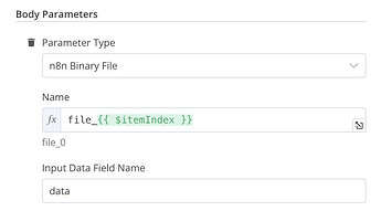

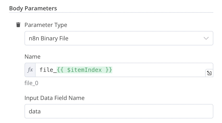

Also, I’m not sure what you mean here:
but you should be able to reference the item’s index number with file_{{ $itemIndex }}:
hope that helps!
