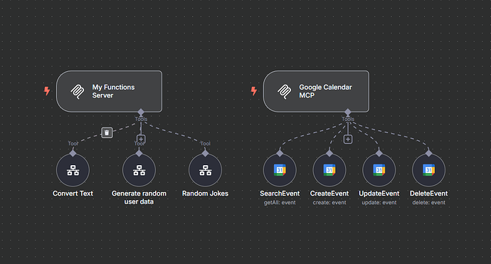

This template shows you how to use MCP Server and Client functionality in n8n with official nodes.
After the release of the new MCP functionality I decided to experiment a little and came up with a template that will help you use this amazing feature.
:warning: Requires n8n version 1.88.0 or higher.
In this example, we use Google Calendar and custom functions as two separate MCP Servers, demonstrating how to integrate both native and custom tools.
How it works
The AI Agent connects to two MCP Servers. Each MCP Trigger (Server) generates a URL exposing its tools. This URL is used by an MCP Client linked to the AI Agent.
Whenever you make changes to the tools, there’s no need to modify the MCP Client. It automatically keeps the AI Agent informed on how to use each tool, even if you change them over time.
