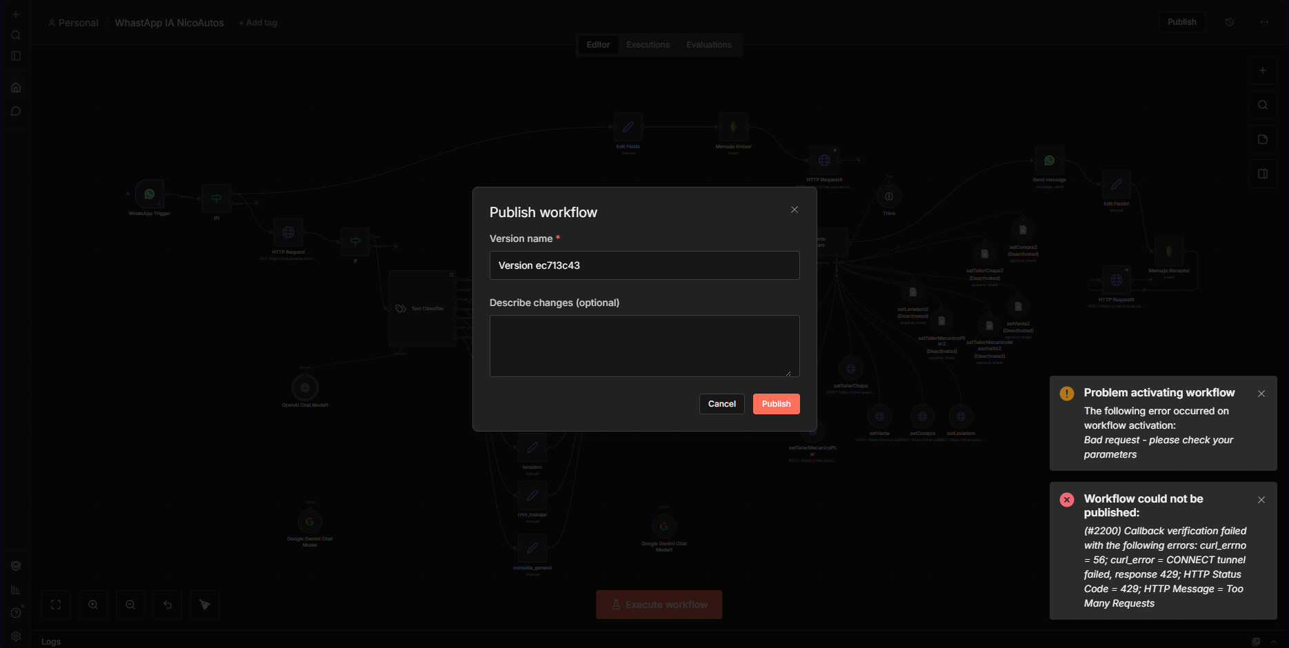

Callback verification failed (Error 429) while saving workflows with whatsapp trigger behind Nginx
I am experiencing a persistent HTTP 429 (Too Many Requests) error combined with a curl_errno = 56 whenever I try to manually save a workflow. This happens consistently on a self-hosted instance. After analyzing my Nginx logs, I noticed bursts of telemetry data and external webhook hits (Facebook) that seem to be saturating the connection or triggering a rate limit, preventing the editor from saving the workflow JSON.
(#2200) Callback verification failed with the following errors: curl_errno = 56; curl_error = CONNECT tunnel failed, response 429; HTTP Status Code = 429; HTTP Message = Too Many Requests
The nodes execute correctly, but the UI fails to persist the changes to the database due to the 429 error during the POST request to the internal API.

  • Activation Issues: When I try to publish the workflow, I consistently get the error: ‘Callback verification failed… HTTP Status Code = 429; Too Many Requests’.
  • Inconsistent Behavior: To get the workflow to actually publish, I have to refresh the page and click the ‘Publish’ button multiple times. It only works after several attempts.

  • Error when publishing the workflow that contains the whastapp trigger node. Error message:

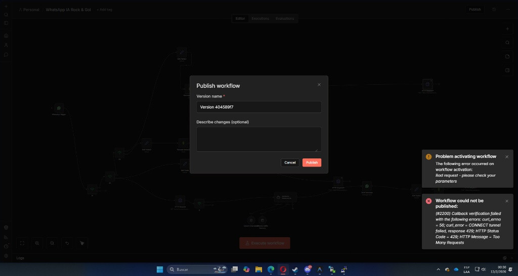

I’m reaching out because, unfortunately, the issue we previously discussed has started occurring again. Despite the initial fix, the same error message has resurfaced in my workflow.
Error:
Workflow could not be published:
