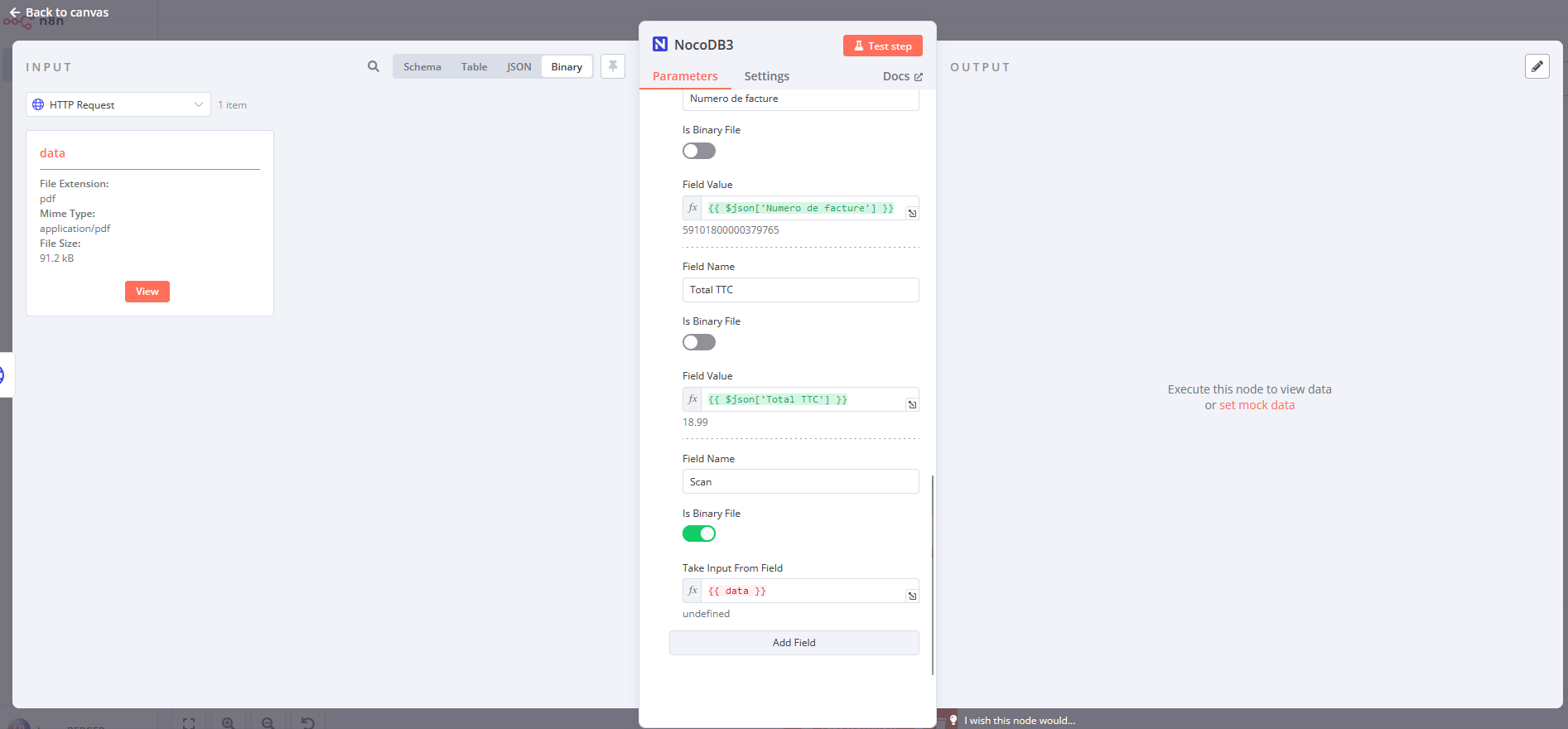

I have a simple workflow that:
  1. Gets a file with a GET request
  2. Create a record in a NocoDB table
When I set:
  • data : Error Bad request - please check your parameters. { "msg": "No attachment provided!" }
  • {{ data }}: The record is successully created with the data excepted for the file which is not showing in the NocoDB row. I do not have any error displayed.
  • {{ $binary}} or {{ $binary.data }}: I have the following error : The item has no binary field '[object Object]' [item 0].
The previous node correctly gets the file : If I click on View I can see the pdf correctly.
What should I put it the last field?
  • n8n version: 1.57.0
  • Database: SQLite
  • n8n EXECUTIONS_PROCESS setting: own
  • Running n8n via: Docker

Hey @Flavio_Orfano ,
Thing are getting interesting:
I already tried to set the field to fixed data but I have the error : Bad request - please check your parameters { "msg": "No attachment provided!" }. Makes sence because data == {{ data }}.
But what is interesting is that it is working with an image I got online but not a pdf I got from Airtable. Notice the button Download visible for the picture but not the pdf. You have the Download button as well. It is just like if the previous step did not download the pdf file correctly.
