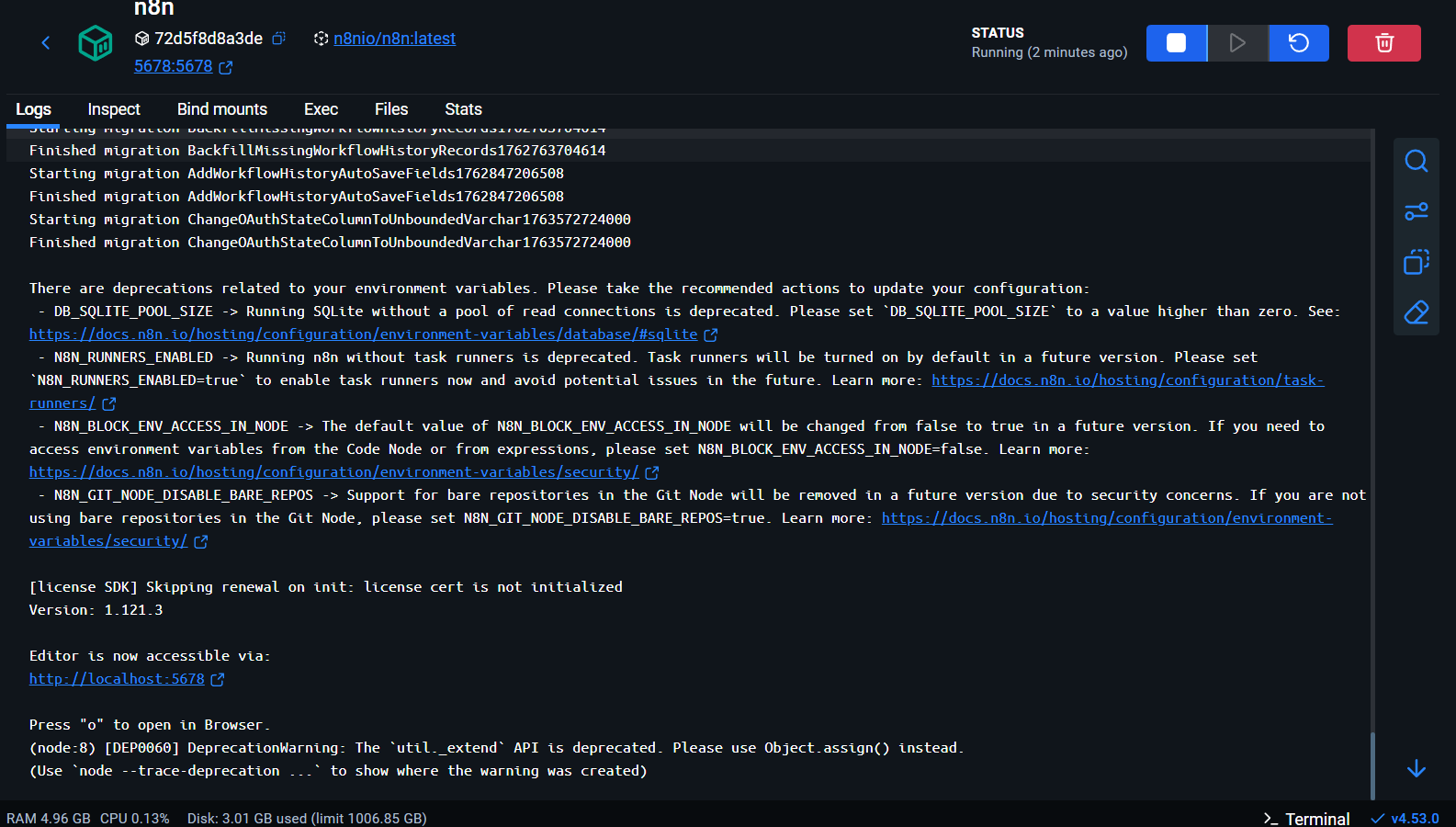

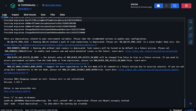

I’m currently on wsl. Using docker I ran the container with the commands given in the setup readme.
docker volume create n8n_data
docker run -it --rm --name n8n -p 5678:5678 -v n8n_data:/home/node/.n8n docker.n8n.io/n8nio/n8n
These are the logs

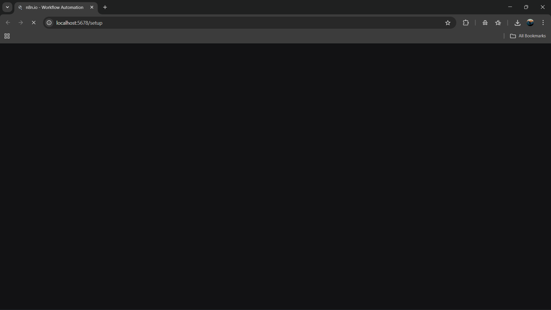

After this when I open the http://localhost:5678 this is the page I can see and it doesnt load at all.

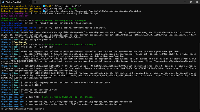

I also tried running without docker using pnpm in that scenario I can see the memory hike in my system

The issue is, when I open up the instance on the browser, the ui never render, even if it renders its unresponsive I cant even able to open console.
Even if you clear caches or open the page from a incognito tab?

I tried opening it in incognito and it works, but was not updating on code changes.

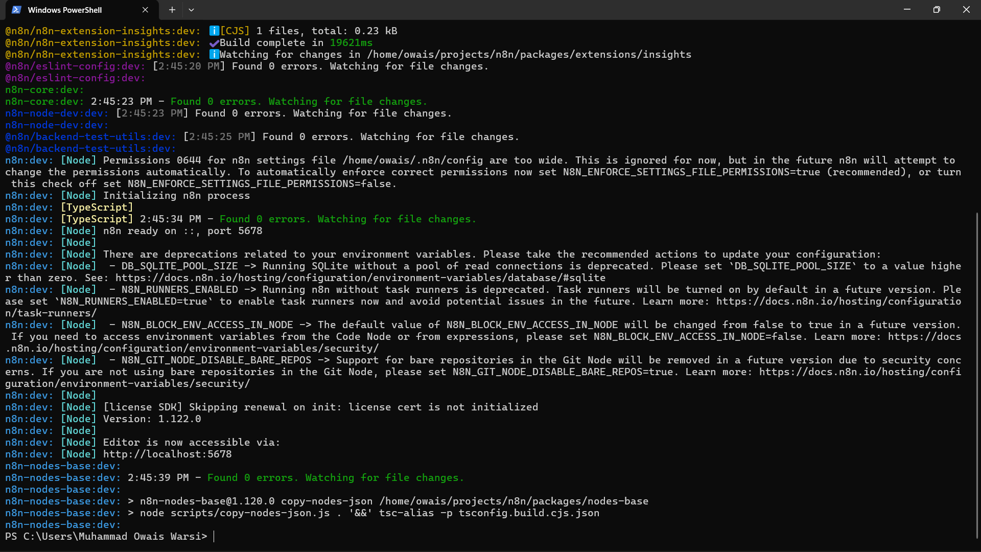

I think you misunderstood me. I cloned the repo and ran the following commands
  • pnpm install
  • pnpm build
  • pnpm dev

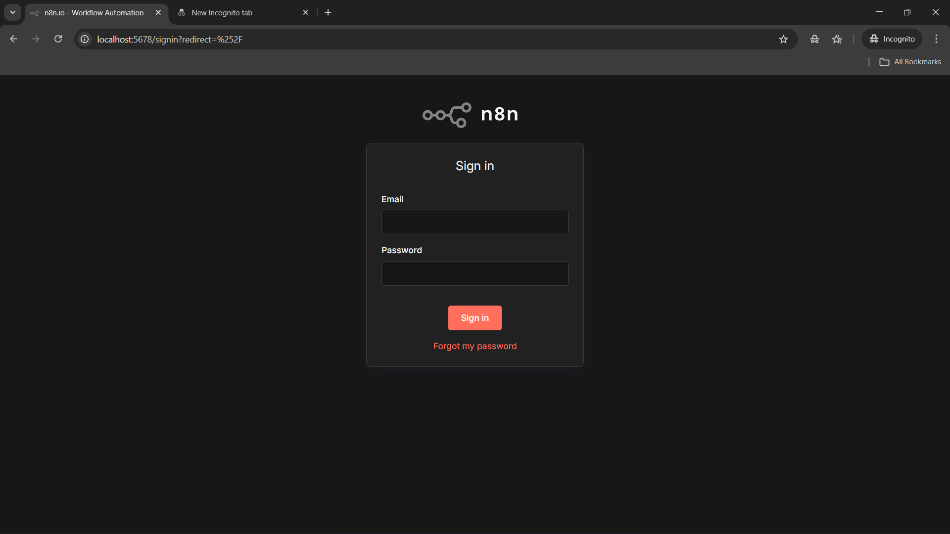

after that I opened up the tab in incognito and got this interface , but now its says invlaid credentials.
Even though I tried with my actual credentials as well as mock.
Ok them, now it’s clear.
If you managed to get it working but have problems to access, try reset credentials:
n8n user-management:reset
Or docker :
docker exec -u node -it n8n user-management:reset
Then restart your instance.
Ran into another issue now. My wsl automatically stops working once the build is complete.
In the image, we can see that I’m outof wsl environment.
To add here as well, the crash is dues to memory-intensive. 8GB RAM is often not enough, and the process can be killed due to running out of memory. The recommendation is to have at least 12–16GB of free RAM during the build process.
So, allocate to your WSL VM more resources.
