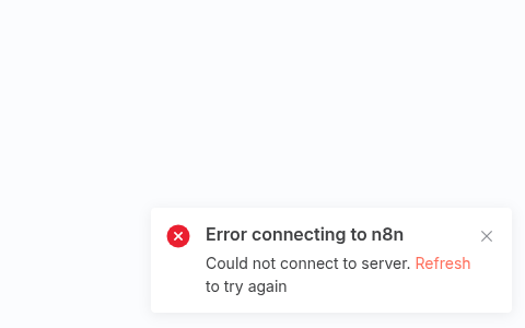

Error connecting to n8n Docker

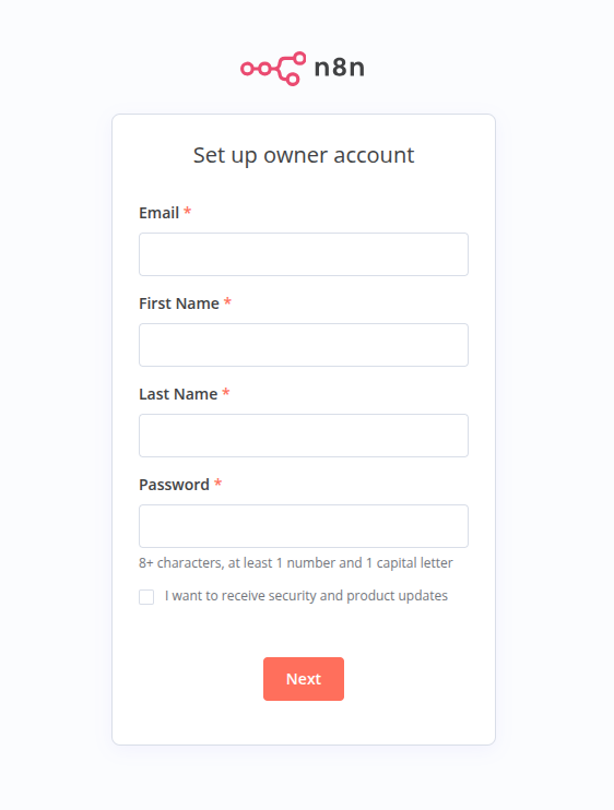

Have 2 Docker Container on 2 different Docker Hosts.
One ist working fine and the other gives this error both have the same docker-compose.yaml
Hi, were u able to fix it? how? got same error and cannot find anything on logs

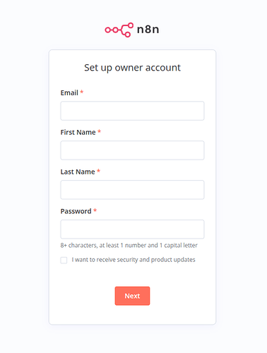

curl 192.168.178.50:5678
	<title>n8n.io - Workflow Automation</title>

I recognize browser Issues: Using the same browser on one n8n docker container running in my lokal LAN - everything ist fine. while accessing a second instance running offsite via a wireguardes vpn connection to this machine it throws Browser errors.
(index):1 The Cross-Origin-Opener-Policy header has been ignored, because the URL’s origin was untrustworthy. It was defined either in the final response or a redirect. Please deliver the response using the HTTPS protocol. You can also use the ‘localhost’ origin instead. See Secure Contexts and HTML Standard.
(index):1 The page requested an origin-keyed agent cluster using the Origin-Agent-Cluster header, but could not be origin-keyed since the origin ‘http://192.168.178.50:5678’ had previously been placed in a site-keyed agent cluster. Update your headers to uniformly request origin-keying for all pages on the origin.
router-BjlAR2wH.js:1370 TypeError: Cannot read properties of undefined (reading ‘ldap’)
at Proxy.initialize (sso.store-BN_yDmsC.js:16:22)
at Proxy.wrappedAction (useTelemetry-BTUGwy7s.js:563:14)
at initializeCore (router-BjlAR2wH.js:389:11)
at async router-BjlAR2wH.js:1345:3
(anonymous) @ router-BjlAR2wH.js:1370
Current Setup uses no reverse Proxy (no nginx/ no traefik) due to the fact that it is a local testing env.
Downgraded to version 1.73.1 solved the issue, after that i upgrades to latest version - trying to pull higher versions so far it works with latest after interims downgrade of container - the hell knows why browser had issues with this.
