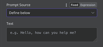

Hello, is there any way to change system message to chatGPT which is connected to Vector Base?
I see this: “System: Use the following pieces of context to answer the users question.
If you don’t know the answer, just say that you don’t know, don’t try to make up an answer.”
But it works very poor for my purposes…

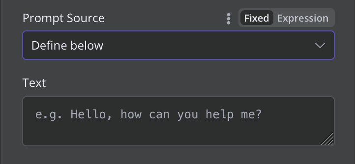

You need to change the value of the field Prompt Source to “Define below” to have it customized.
