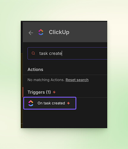

Running a simple workflow catching CRUD-events from ClickUp tasks using the default ClickUp trigger node works fine while testing.
However, as soon as I publish the workflow, the real executions throws errors. And even through “Retry on fail” is off, it seems like it keeps throwing many errors just from one event.
