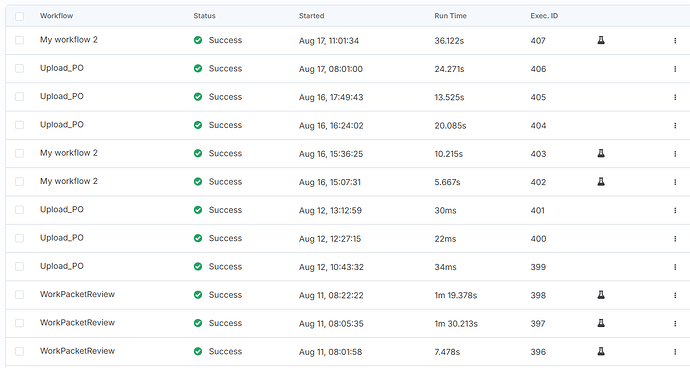

Could you check Executions to confirm the workflow was triggered and review previous runs for any errors. Next, manually trigger the Watch node to verify that Credential 2 is working.
Yes. When I trigger the Workflow manually and mark an email as unread, it works perfectly.
Notice no automatic executions of Workflow 2 but Upload PO works fine.
