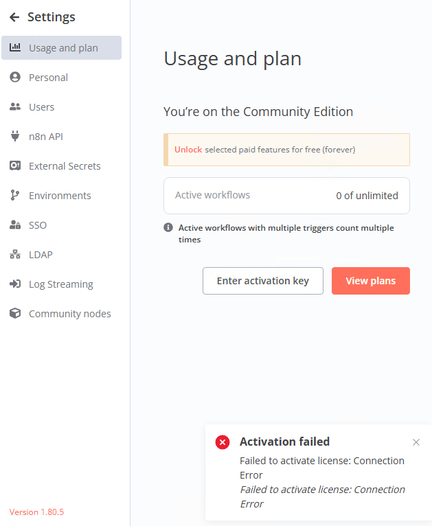

I’m getting a “Failed to activate license: Connection Error” response when trying to activate the community license with n8n.
We are self-hosting n8n on the latest version. We’re installed using npm.
In the documentation, I see the license server URL as being http://license.n8n.io/v1, and that then redirects-ish to https://license.n8n.io/v1. But https://license.n8n.io/v1 gives a 404 error…
We do use a proxy to get out to the internet from this server, but we’re not seeing any drops from that. The “send me a free license key” process does work, and I’ve received the key via email. But I’m unable to activate it. Workflows I’ve tried do work… I’m not sure what else to try.

and I’m still getting a connection error when using the UI:
