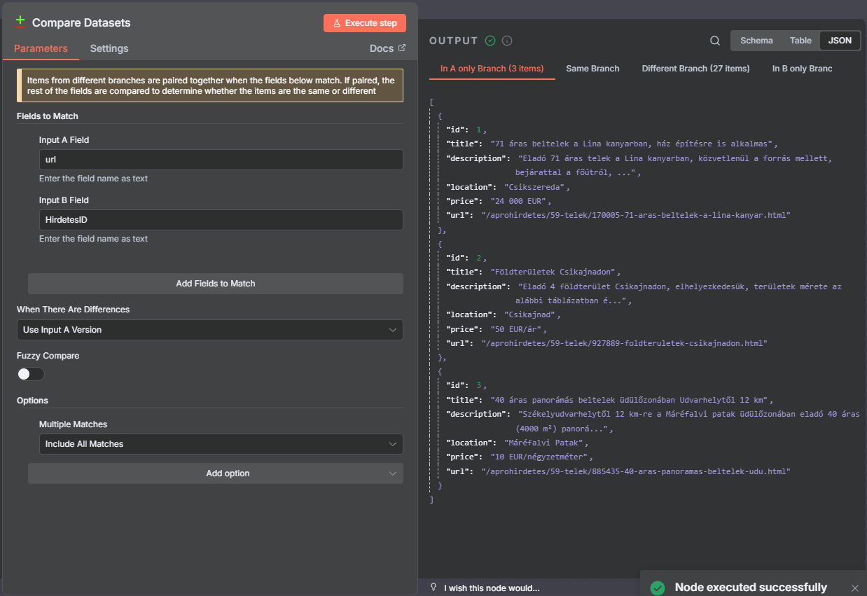

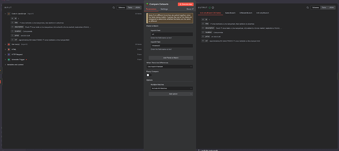

I tried to use the Compare datasets node to compare the two sources and identify the newly added properties, but I can’t make it work correctly:
If you take a look to the output schema mode, it shows one result (instead of two, because there is 28 url in the Data tables and 30 in the html output), and if I switch to table or JSON view it shows 30 results. I also added a telegram node, but when I execute the step it sends me 30 messages instead of the newly added 2 properties’ notification. What am I doing wrong? Probably it has to be something straightforward that I can’t figure out. Thank you for your help!

Hi @roundedhexagon
Why aren’t you linking the Get row(s) node?

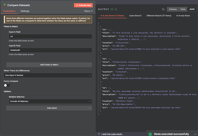

After I linked it, I got this output:
Maybe this is what you’re looking for?

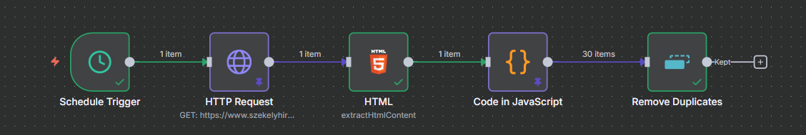

Also for your information, there’s another built-in node you can use to get only the new items in each execution without needing to save them in a database and compare manually..
It’s the Remove Duplicates node:

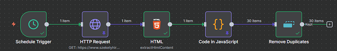

You can use it like this:
and each new excution you will only get the new items:
It’s easy to use, especially if your use case is simple and straightforward,
for example, when you just want to get only the new items in each execution compared to the previous one..
This solved the issue! Thank you for your help @mohamed3nan I have no idea what I haven’t connected the data tables node to the trigger! That solved my issue instantly :slight_smile:
