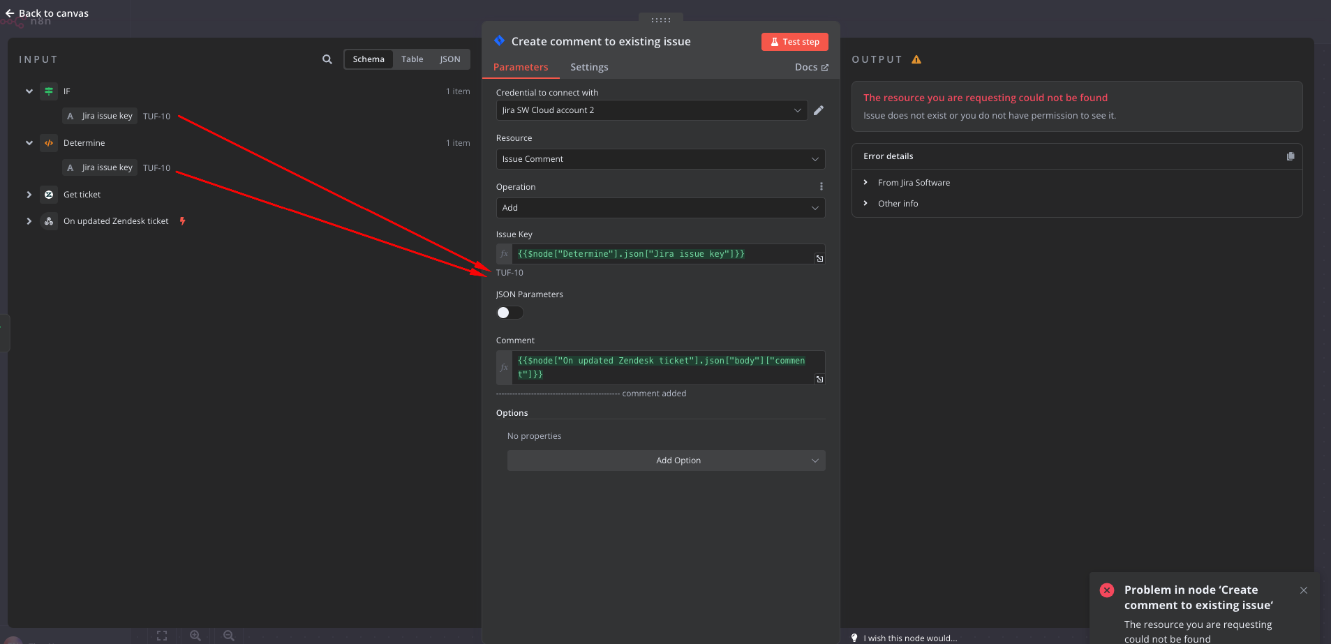

Could not sync Zendesk tickets with subsequent comments to Jira issues
I use this template to sync Zendesk tickets to Jira issues. It works for “create Jira issue” flow. For “update with new comments on existing Jira issue” flow, it returns an error message “The resource you are requesting could not be found. Issue does not exist or you do not have permission to see it.” as below image.

In the workflow you have shared the Create comment to existing issue node is not using an expression although from your screenshot you was using it.
Looking at the error Jira is saying that the issue either doesn’t exist or the account you are using doesn’t have access to it. Have you made sure that your user does have access to it?

Hi @Jon I haven’t noticed any differences in the configuration of my shared workflow compared to the attached email in the previous comments on this topic. For your reference, I’ve reattached the below image of configuration for my current workflow for the “Create Comment to Existing Issue” node.
As you can see in my shared workflow, I use the “IF” node to check whether the Jira issue exists. If it doesn’t exist, the “Create New Jira Ticket” node will execute; otherwise, the “Create Comment to Existing Issue” node will run.
As I mentioned in my first comment, the “Create New Jira Ticket” node is still functioning normally. Therefore, I believe the issue may be related to the configuration of the “Create Comment to Existing Issue” node.
Hi @Tien_Nguyen
I could not recreate the issue either. This might be related to your code node.
Can you try to reference the issue directly from the If node instead of from the Code node?
So instead of {{$node["Determine"].json["Jira issue key"]}} for your Issue Key → {{ $json["Jira issue key"]}}
Hi @ria, it’s working now! The issue wasn’t with the node code, but rather with the configuration of my Zendesk trigger.
