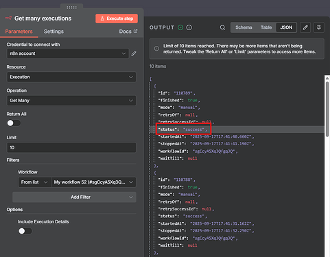

Hi @mohamed3nan Thanks for taking your time and sharing the details.
I have tried the option of Get Many Executions with limit 1, considering that API is returning the latest data.
Testing:
  • I have executed the flow manually and in the flow kept the wait for 3mins.
  • While this flow is in-progress, I have send the request to n8n api directly, I was expecting the current execution will come in response but unfortunately it sharing me the already completed flow.
And i have observed that i am not seeing the status field in the response

Hi @mohamed3nan I have spoken to n8n support, the current n8n API will not able to show the in-progress execution status, this feature in beta.. planning to release in next couple of weeks.
That’s right, I actually haven’t implemented the full logic in the example I mentioned..
But if you query with the execution id while the workflow is running, you’ll get status: running.
And it’s great news that the in-progress execution status feature will be released soon..
