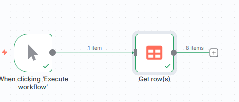

It works fine if i have a seperate workflow and the trigger is starting the “Get row(s)” (pointing to the same data table, same options etc.)

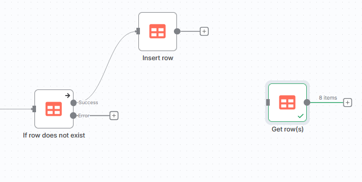

Trying to continue using the now present Rows after a new row might be inserted, no data in the “Get row(s)” node.
Just the “Get row(s)” Node on its own:
The Get Data Node does not contain the data from the data table if wired to the “If row does not exit” Error Output and “Insert row” node.

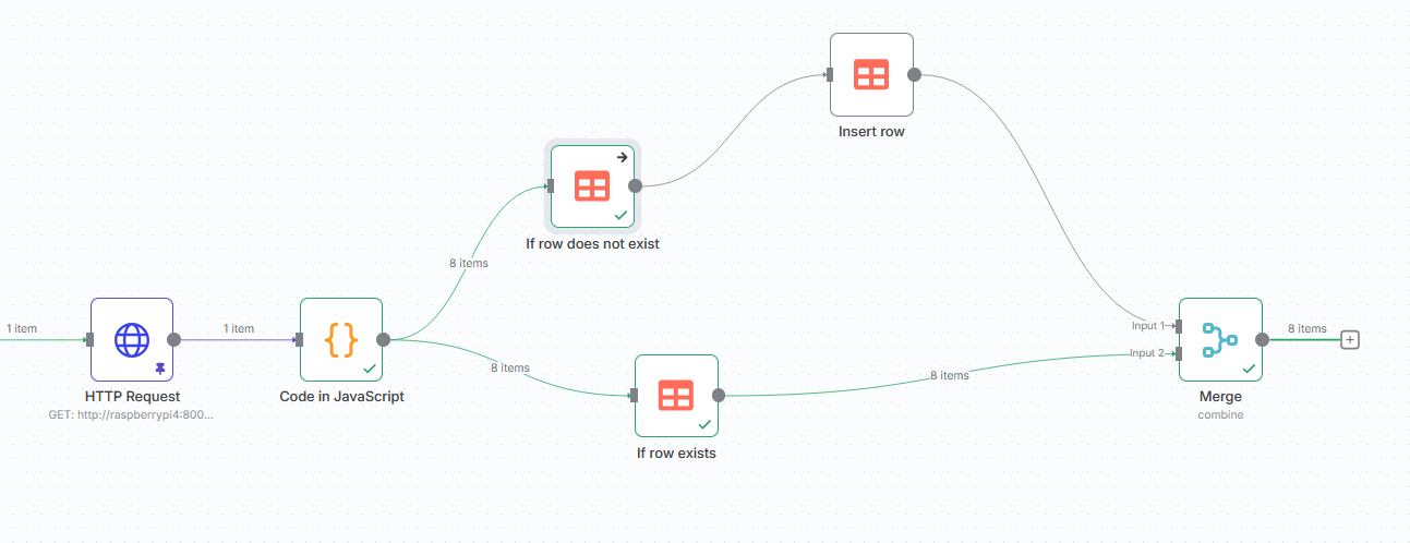

I think you have misunderstood success and error here.
success here means node executed successfully if that value exist or not it will be executed.
error will means that node not executed successfully like mismatch in variable type or table does not exist etc.
you should try like this:
if row exist then top flow will not continue as it will not have any output.
and vice versa.
Thanks, this was the Solution, by using “If row does not exist” and “If row exists” and then using a merge enriching the bottom flow with the top flow.
