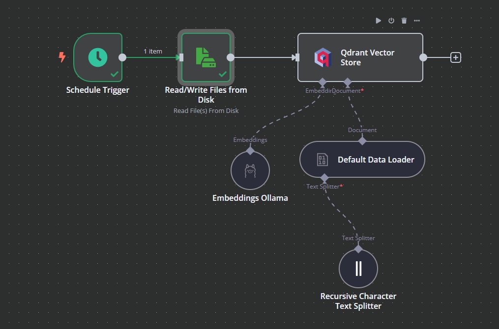

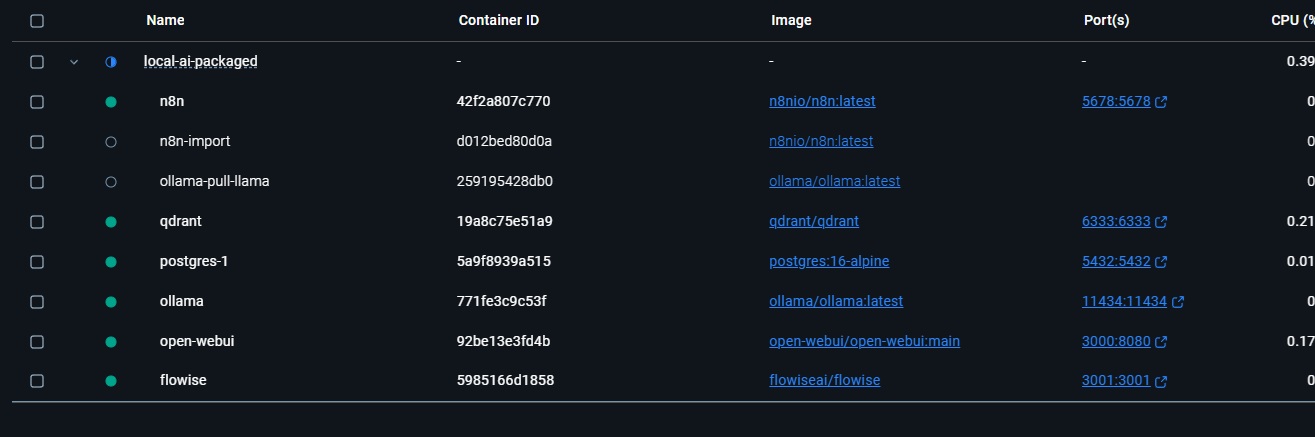

I’m working with the “N8N Self-Hosted Starter Kit” from “https://github.com/n8n-io/self-hosted…” image 01.
This is the progress of my workflow image 02

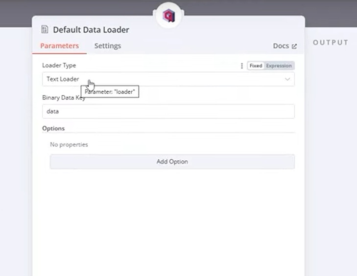

This is what I see in the “default data loader” image 03

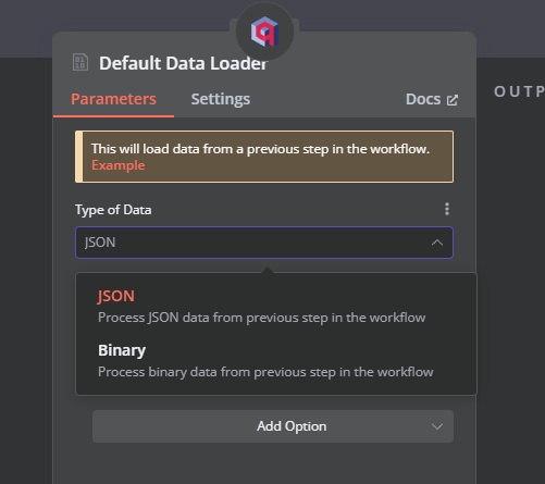

This is what it should look like according to the tutorial image 04
I successfully tested the “Schedule trigger” of the “READ/Write files from disk” of the “Qdrant vector store” of the “Ollama embeddings”. However, testing the default data loader shows me the following error image 05
I think that is just a name change because of added features.
To make it look like your tutorial, you can set it up like this:

Thank you very much, Solomon. It worked perfectly. Best regards.
