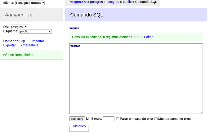

But, after doing some research with adminer.php and other tools I found out that the actual data is being mounted in my Digital Ocean droplet. So, before i’m able to do any Vacuum operation, I will need to find the actual data first lol.

Hum, that is interesting. You should be seeing n8n tables in there, yes.
In any case, the vacuum operation is “global” so if you click the SQL Command link in the left panel you should be able to run it just fine and see if it worked.
Ok, this is strange. If you check other databases, are all of them also empty? Because this might indicate that the connection is being done to another postgres instance that is not the one being used by n8n.
