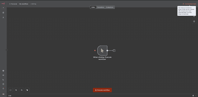

I installed n8n with Docker on my Raspberry Pi with Ubuntu Server and created a tunnel with Cloudflare. For the installation, I followed this tutorial: https://youtu.be/ONgECvZNI3o?si=5_Rca5F3Mlb0y1YE The setup works, I can access n8n but in every workflow it shows “Connection lost - You have a connection issue or the server is down. n8n should reconnect automatically once the issue is resolved.“

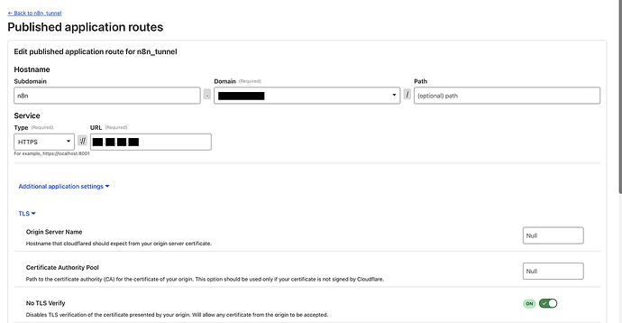

Which settings do you got for your tunnel? I got these and tried your variable but it still shows Connection lost
Hi, so for me it worked by using HTTP and localhost:8080 (my n8n Port):
I was troubleshooting this error 5 hours and it fixed it for me.
Maybe one of those .env variables for my n8n docker container helped too, but the big step was using the cloudflare tunnel.
