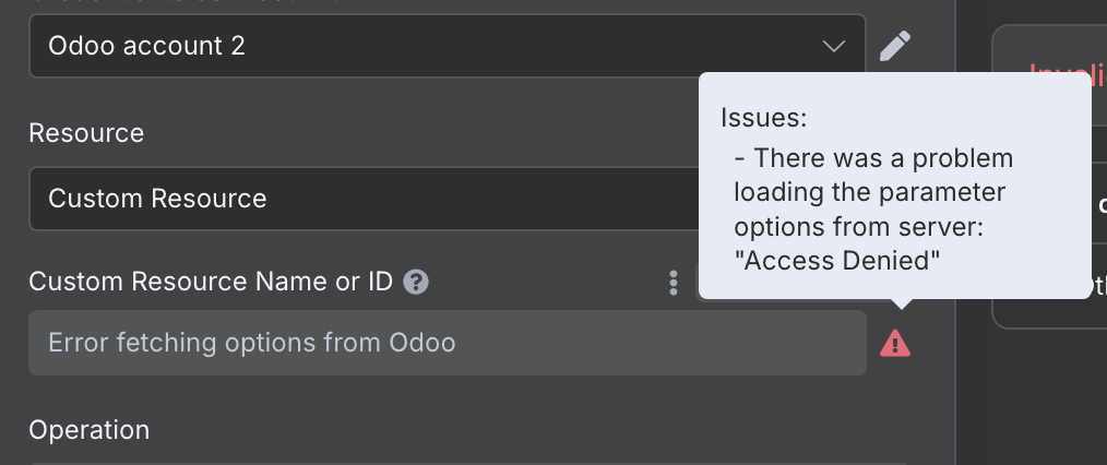

Error in Odoo node "access denied
im having troubles in de n8n Odoo fields, im getting this error
  • There was a problem loading the parameter options from server: “Access Denied”
    as i know, it should be a access permission configuration, but i cant find which one is. the credentials are working fine

Hey Cesar,
i have the same problem. Did you fix it?
Hi all
Trying to connect to ODOO, but can’t get access to custom fields. Same problem here, any help? Thanks Iin advance
you need permission to read records from ir_model
make sure your user has read permission for model ir.model.access
