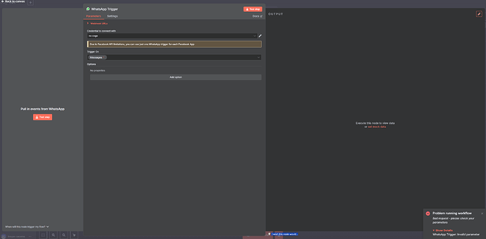

I built my self hosted n8n on my VPS and I’m trying to use a whatsapp trigger node and when I try to run it I get the error.
I’m not able to enter the webhook URL on the whatsapp page, it tells me there is an error so I assume it’s a configuration error of my n8n on my VPS
##ERROR
Problem running workflow Bad request - please check your parameters Show Details WhatsApp Trigger: (#2200) Callback verification failed with the following errors: curl_errno = 35; curl_error = OpenSSL/1.1.1x: error:1408F10B:SSL routines:ssl3_get_record:wrong version number; HTTP Status Code = 200; HTTP Message = Connection established

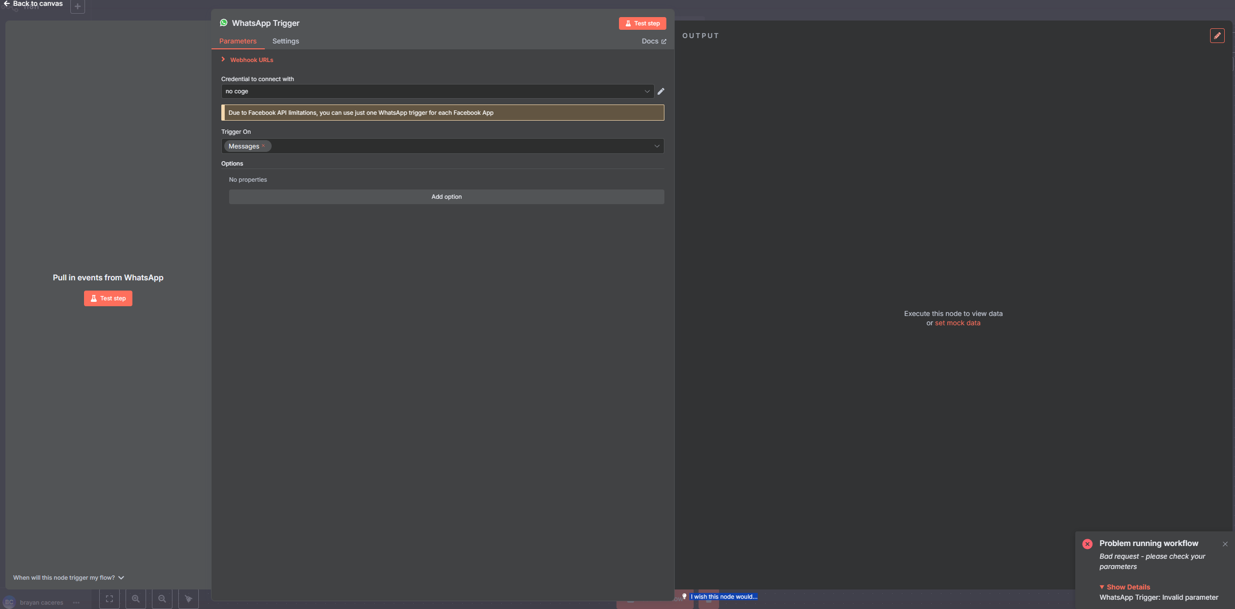

Show Details
WhatsApp Trigger1: (#2200) Callback verification failed with the following errors: HTTP Status Code = 404; HTTP Message = Not Found
