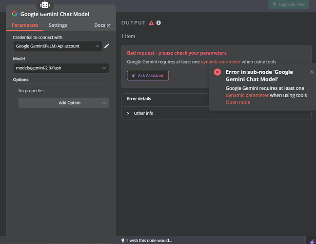

I’m using the Google Gemini Chat Model in n8n and getting the following error:
“Bad request - please check your parameters. Google Gemini requires at least one dynamic parameter when using tools.”
I’ve selected the models/gemini-2.0-flash but didn’t add any additional options. How do I resolve this issue? What dynamic parameters are required?

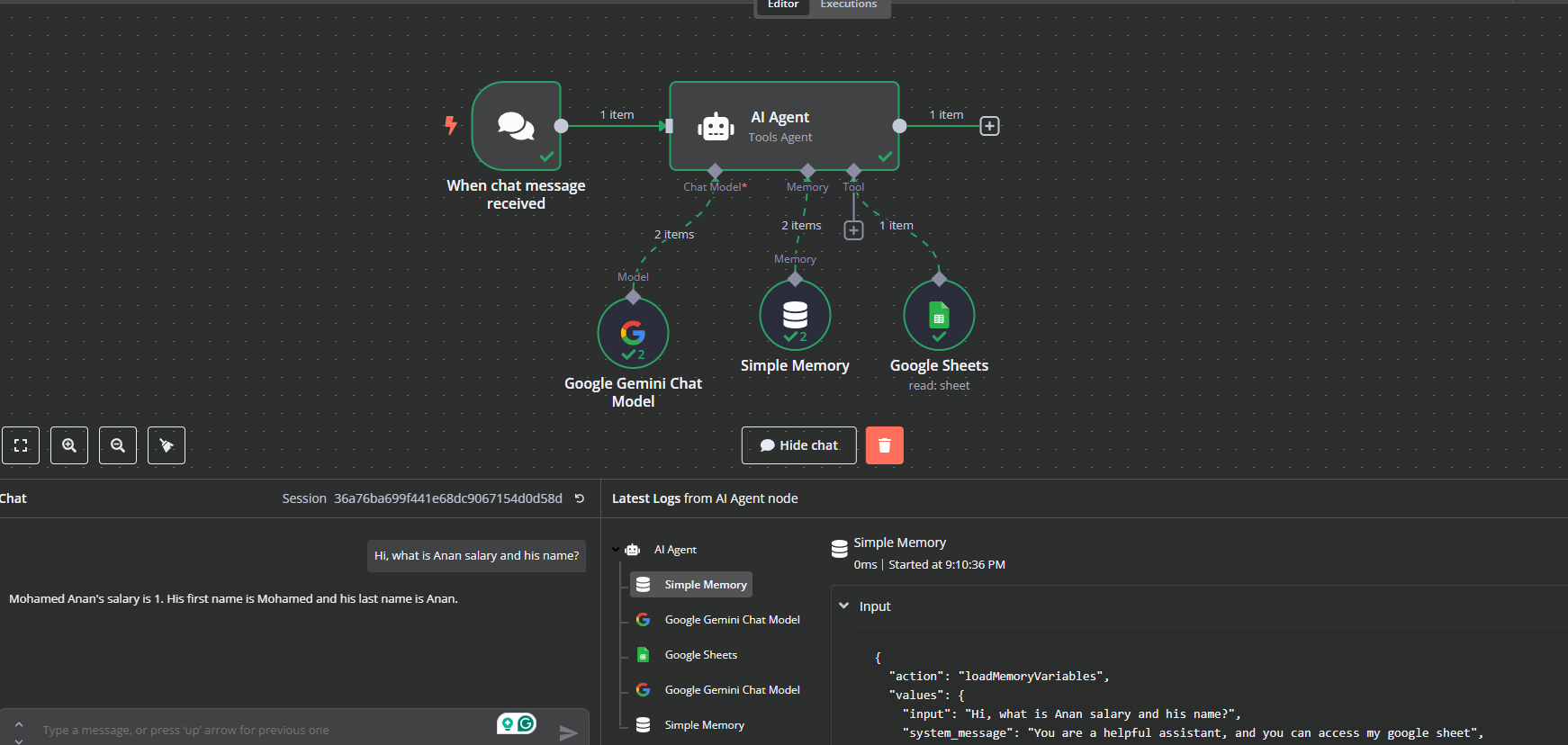

Hello, here is a working example without adding Tool
but in general, this means that you must allow the agent to determine some parameters when using a tool.
If you need further assistance, please share your workflow and the error message so that we can help you more effectively

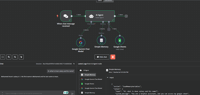

Hi @Banseedhar
In Google Sheet Tool you have to set the columns and let the model handle it “Defined automatically by the model” like this:
here is a working example:
for better results try Gemini pro, in some cases it is smarter..
Hi @mohamed3nan,
Thanks, it’s working fine now, does it require adding all column names explicitly in the sheet parameter setting?
You’re welcome!
I think one is fine—I just tried it, and it was actually able to read all the columns. Just remember to choose a unique column to prevent duplication and confusion.
