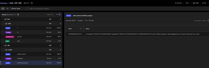

I haven’t been able to solve it yet. Redis is running normally. Executions, even in a test environment, don’t work, they enter a kind of queue.
Even in a test environment, requests enter queue mode and do not execute.
This is the Main (editor) log, notice that the queued entries appear. In the worker log nothing appears.
I deleted the entries in postgres in the execution_entity table then ran it again, see that Redis recorded the execution.
And the entry into postgres also occurred.
It stays like this and doesn’t run.
Forever like this:
