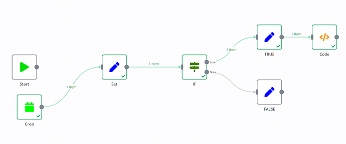

In the execution you can see what nodes did run.
So you can filter to only delete the ones that had a specific node ran or not.
Hope that makes sense.

@joeldeteves Ok so it can be done. :slight_smile:
This is the execution I got.
When getting the execution you can enable the details. In the details you see the nodes that executed. Below you see that the node called “TRUE” is logged and “FALSE” is not. This is what I meant by checking the nodes and its executions.
