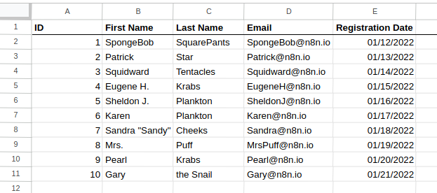

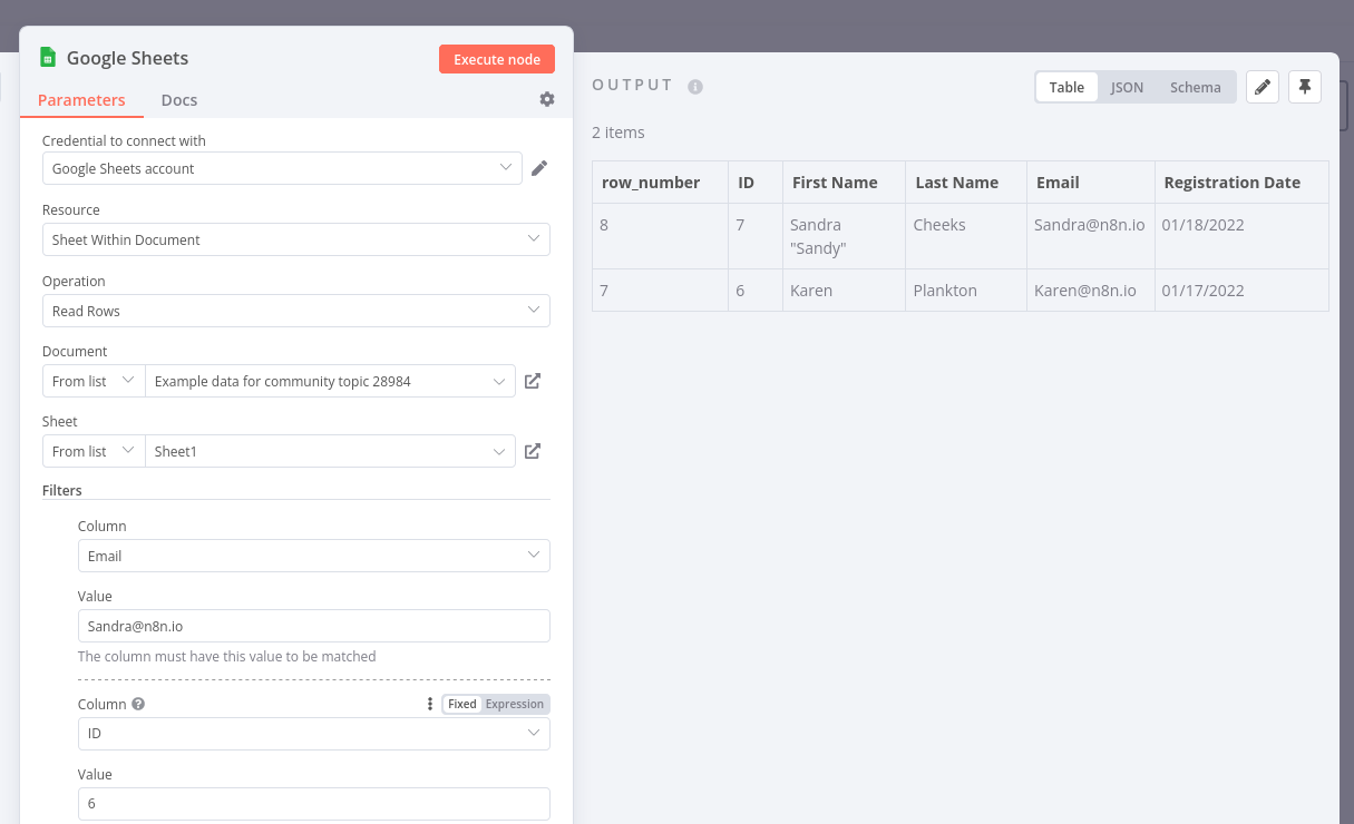

Hi @gmsalomao2, I suspect you will have to filter via a separate node here. The reason for this is that the filters defined in the Google Sheets node will be combined using OR rather than AND which seems to be what you have in mind. Imagine the following Google Sheets spreadsheet:
grafik
Now a filter such as Email = [email protected], ID = 6 would return all rows where either of these conditions is true:
The IF/Filter node on the other hand will allow you to combine multiple conditions using AND. So I think your current approach of combining the two nodes (first filtering the email in the Google Sheets node, then filtering your date in the Filter node) will already be the most suitable one considering these constraints.
