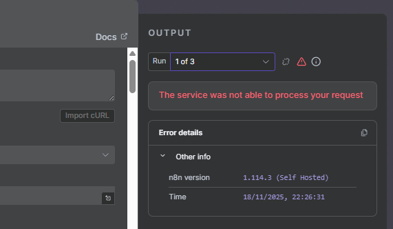

I’m facing an issue when using Tools within the AI Agent node, specifically when one of the tools fails for a valid reason (e.g., an external API returns an expected error).
  • The Problem: When a Tool (which executes an HTTP request) fails within the AI Agent, the only output I receive in the Agent’s response is a generic error: "The service was not able to process your request".

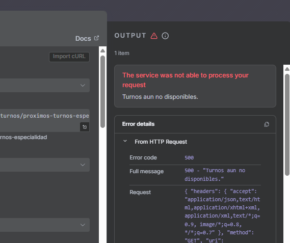

  • The Comparison: If I run the exact same HTTP request outside of the AI Agent (e.g., directly in an HTTP Request node), the error response is much more detailed. I get the full JSON response from the external service, often including a specific “Full message” describing why the service failed.

Here when the ia tool fail:
Here i get the full message description (http request, no ia/tool):
