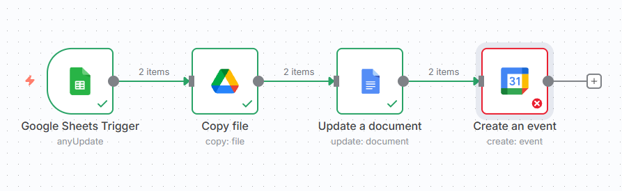

Hi @Sami_dac1 , the expression is valid as the Luxon object creates properly. The porblem is that if the object is created using a hard-written script, the request to Google Calendar works. If the datetime object is created using a variable with the very same value (I double checked and I can preview the value of the Luxon DateTime object), the request doesn’t work.
@jabbson here it is:
Is there a way to debug the actual HTTP requests sent by the n8n Node (with self hosting)? I’d be eager to check what exactly is sent to Google, perhaps the Google Sheet value is not properly injected into the Google Calendar request.

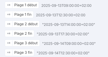

Thanks for an example. I’ve noticed your dates in the sheet are in different format. If you can, try to unify the format to the ISO format without quote marks, like so

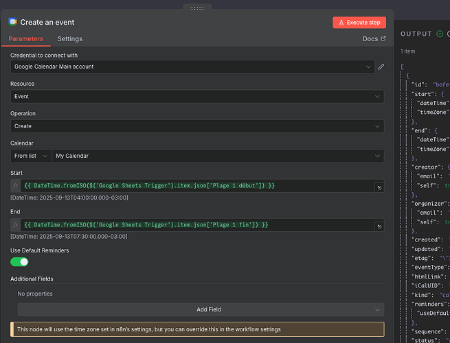

Then in your workflow you can use:
{{ DateTime.fromISO($('Google Sheets Trigger').item.json['Plage 1 début']) }}
{{ DateTime.fromISO($('Google Sheets Trigger').item.json['Plage 1 fin']) }}
Hi @jabbson , the issue is not the format, I’ve tried your approach exactly but I face the same issue: event creation works if I write the date as a string directly, for instance:
{{ DateTime.fromISO("2025-09-13T08:00:00.000-04:00") }}
And I get a bad request from Google Calendar with the exact same date but as a variable:
{{ DateTime.fromISO($('Google Sheets Trigger').item.json['Plage 2 début']) }}
The date is being parsed properly, it’s the calendar event creation call that fails. This is extremely weird and I am surprised that it works on your side.
The date doesn’t work when it is surrounded by quotation marks in the sheet. Here is a video, where I used your document (a copy of it) and your first and last node:
As you can see, when I try to create an event for “Plage 1”, it creates it with no problem (notice no quotation marks for the date), when I switch to the “Plage 2”, it throws an error.

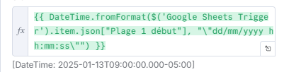

Hi @jabbson , thanks a lot for your help, but I confirm again that this is not the issue. I do have an error even when I use the dates with a valid format. The Luxon DateTime object is created properly, indicating that the format is recognized for the dates I try. You’ll find different formats in the file exactly because I did investigate in this direction, and this is not the issue.
