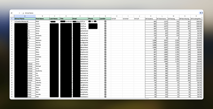

Have a Row Updated causing issues (I think). The error is: `There was a problem activating the workflow: “Cannot read properties of undefined (reading ‘!ref’)” anytime I try to activate the workflow. When I manually test it, it works fine.
I decided to use the Data Location on Sheet option, like over here.
I used this same exact workflow many times in previous versions of N8n (1.91.0 also didn’t work).
I duplicated the sheet (left the name unchanged as mentioned in the previous link suggestions as it appears a sheet name-change can cause issue) and was able to immediately save the Workflow. However, it would not trigger when I updated a row in the specified column. I tried deleting the Data Location on Sheet and my flow was disabled and anytime I try to reactivate it, I get the same initial error.
Any idea what is going on? As I said, I’ve ran this same workflow thousands of times previously.

Trigger is rowUpdate.
The behavior is the same (initially built without Data Location on Sheet). The row ranges (A1:Z1000) also produced the same result. I’ve since deleted the Data Location on Sheet option entirely.
Header row and data range doesn’t have any hidden rows, columns or weird formatting. Although, I believe this may be the first time I’ve used $ in cell values.
Just duplicated it again and was immediately able to save (previous attempt also allowed me.). Looks like it IS actually firing now.
