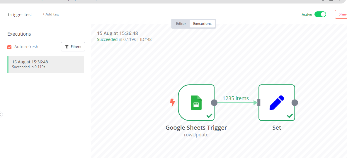

Hey,
I update only some rows on Google Sheets but it returns all rows everytime. I activated the flow, tried to create a new flow and a new google sheet module.

I think there are some solid problems about google sheet trigger node. I keep trying things options part as well but it doesn’t work. Or I am wrong.

I read the forum and saw this answer before. So that’s why I spesically tried when the flow is active. I kept trying by triggering the sheet trigger, it was the same result on each one as it can be seen on the screenshots.
