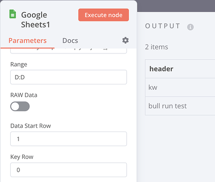

I believe the problem you face is due to wrong configuration where you have specified incorrect range of data, more specifically “Data Start Row”/“Key Row”. It would help if you could provide the node configuration and how the data is presented in the spreadsheet.
For example, here’s the 2 outcomes for querying the same data:
Correct range
Invalid range

Yes, I used the old version as I assumed you are using the old version too. I still believe you might be using the old version of the node despite having the new version of the app. The reason for that is your screenshot does not show row_number column which is present in the newer version of Google Spreadsheet node as in the screenshot below.
