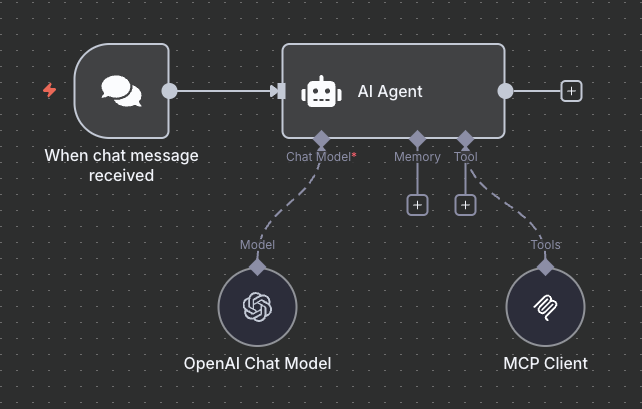

Hey @JoeTannorella hope all is well.
In order to connect your MCP Server to LLM, you can connect MCP Client tool to the AI Agent like so:
Thanks. It turns out that I wasn’t on a new enough version of n8n.

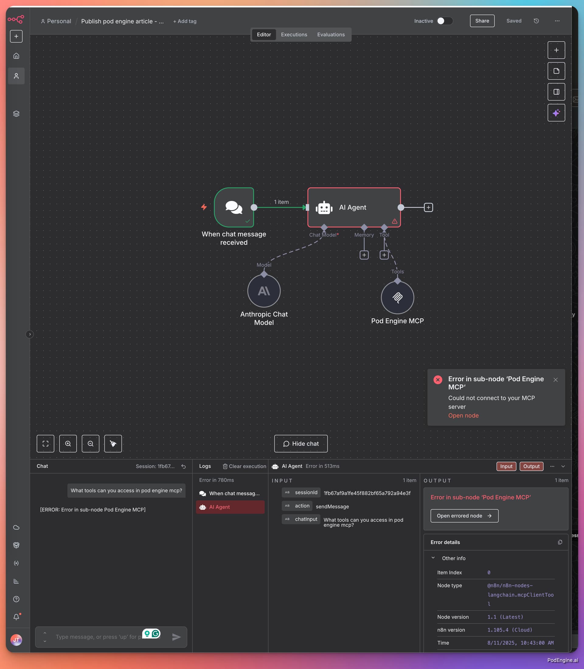

I’ve updated the server now but get an error:
NodeOperationError: Error in sub-node Pod Engine MCP at ExecuteContext.getInputConnectionData (/usr/local/lib/node_modules/n8n/node_modules/.pnpm/n8n-core@file+packages+core_@opentelemetry+api@1.9.0_@opentelemetry+sdk-trace-base@1.29_46e522f8a77ed5eccc0991bfcca21502/node_modules/n8n-core/src/execution-engine/node-execution-context/utils/get-input-connection-data.ts:302:11) at processTicksAndRejections (node:internal/process/task_queues:105:5) at ExecuteContext.getInputConnectionData (/usr/local/lib/node_modules/n8n/node_modules/.pnpm/n8n-core@file+packages+core_@opentelemetry+api@1.9.0_@opentelemetry+sdk-trace-base@1.29_46e522f8a77ed5eccc0991bfcca21502/node_modules/n8n-core/src/execution-engine/node-execution-context/execute-context.ts:203:10) at getConnectedTools (/usr/local/lib/node_modules/n8n/node_modules/.pnpm/@n8n+n8n-nodes-langchain@file+packages+@n8n+nodes-langchain_c7791fa0cf1054f8be91f739b153c14e/node_modules/@n8n/n8n-nodes-langchain/utils/helpers.ts:208:5) at getTools (/usr/local/lib/node_modules/n8n/node_modules/.pnpm/@n8n+n8n-nodes-langchain@file+packages+@n8n+nodes-langchain_c7791fa0cf1054f8be91f739b153c14e/node_modules/@n8n/n8n-nodes-langchain/nodes/agents/Agent/agents/ToolsAgent/common.ts:319:17) at /usr/local/lib/node_modules/n8n/node_modules/.pnpm/@n8n+n8n-nodes-langchain@file+packages+@n8n+nodes-langchain_c7791fa0cf1054f8be91f739b153c14e/node_modules/@n8n/n8n-nodes-langchain/nodes/agents/Agent/agents/ToolsAgent/V2/execute.ts:222:18 at async Promise.allSettled (index 0) at ExecuteContext.toolsAgentExecute (/usr/local/lib/node_modules/n8n/node_modules/.pnpm/@n8n+n8n-nodes-langchain@file+packages+@n8n+nodes-langchain_c7791fa0cf1054f8be91f739b153c14e/node_modules/@n8n/n8n-nodes-langchain/nodes/agents/Agent/agents/ToolsAgent/V2/execute.ts:290:24) at ExecuteContext.execute (/usr/local/lib/node_modules/n8n/node_modules/.pnpm/@n8n+n8n-nodes-langchain@file+packages+@n8n+nodes-langchain_c7791fa0cf1054f8be91f739b153c14e/node_modules/@n8n/n8n-nodes-langchain/nodes/agents/Agent/V2/AgentV2.node.ts:117:10) at WorkflowExecute.runNode (/usr/local/lib/node_modules/n8n/node_modules/.pnpm/n8n-core@file+packages+core_@opentelemetry+api@1.9.0_@opentelemetry+sdk-trace-base@1.29_46e522f8a77ed5eccc0991bfcca21502/node_modules/n8n-core/src/execution-engine/workflow-execute.ts:1212:9) at /usr/local/lib/node_modules/n8n/node_modules/.pnpm/n8n-core@file+packages+core_@opentelemetry+api@1.9.0_@opentelemetry+sdk-trace-base@1.29_46e522f8a77ed5eccc0991bfcca21502/node_modules/n8n-core/src/execution-engine/workflow-execute.ts:1582:27 at /usr/local/lib/node_modules/n8n/node_modules/.pnpm/n8n-core@file+packages+core_@opentelemetry+api@1.9.0_@opentelemetry+sdk-trace-base@1.29_46e522f8a77ed5eccc0991bfcca21502/node_modules/n8n-core/src/execution-engine/workflow-execute.ts:2158:11
It appears that the Pod Engine MCP node cannot connect to the MCP server… Why? I don’t know, neither logs nor the screenshot has this info. Is this a locally accessible server or something you can share for me to try?
