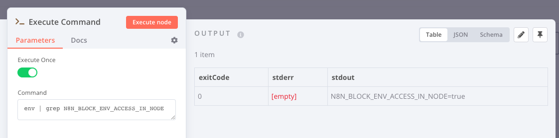

Which is what I did but found that it does not prevent a code node to access theses variables!
Well the screenshot it quite weird, it clearly print the vars that say it shouldn’t be able to access it! :laughing:
I’ve checked manually on all pods and they all have the boolean to true.
Am I missing something? If that’s the expected behavior, how can I prevent user from accessing them?
My concern is that when you print the full env, you can therefor get the path where the secrets are stored and by just rerunning the code node with cat, you retrieve everything!

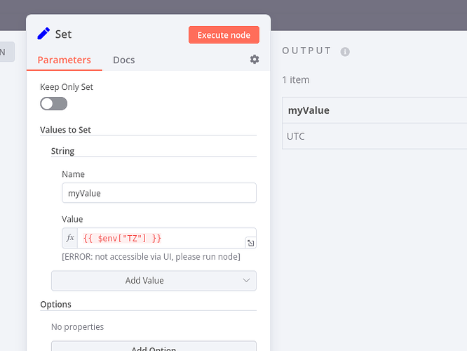

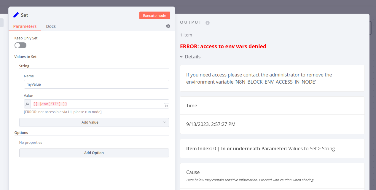

I am sorry for the confusion caused here. This environment variable will prevent the use of the $env expression which allows you to access environment variables as part of your workflow:
This is how it’d look without the environment variable:

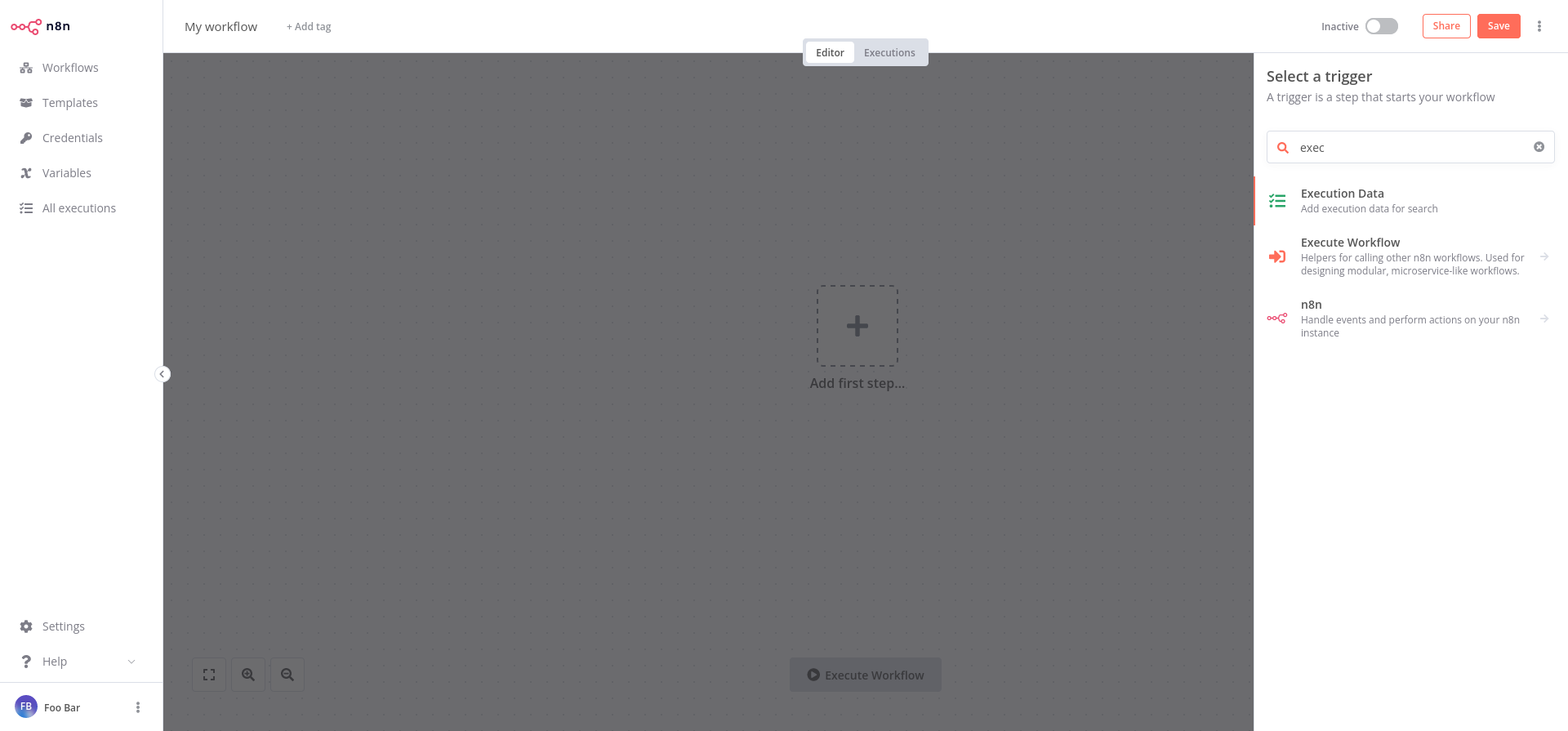

Exactly, this line should do the job. n8n will then no longer offer the Execute Command node:
Trying to copy the Execute Command node from another n8n instance will also fail and the workflow cannot be executed:
