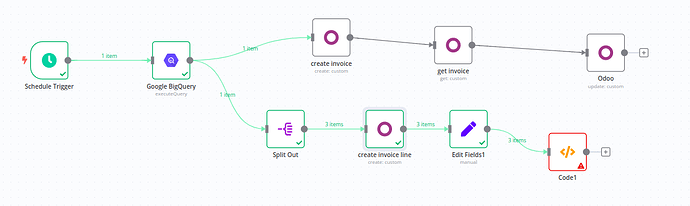

I want to convert an object into an array using code node, but I’m having trouble because I don’t have basic JavaScript. so I want to merge the invoice line id to the invoice after it is created. but invoice line is an object. Meanwhile, 1 invoice can have several invoice lines stored in array

Why you need a Code node for it? You can use the Split Out node that is much easier to use
can split out use for object to array? i already use it to split projects from array to object before.

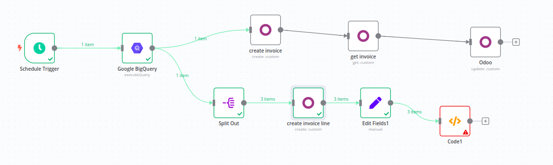

i want to make json like this.
before
after
You can use the Aggregate node:
that works!! thank you so much
I have merged the invoice with the invoice line. and want to update the invoice. but get an error like this. what should I add in the invoice_line_ids field?
