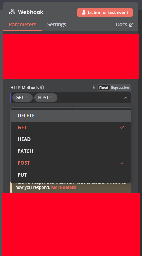

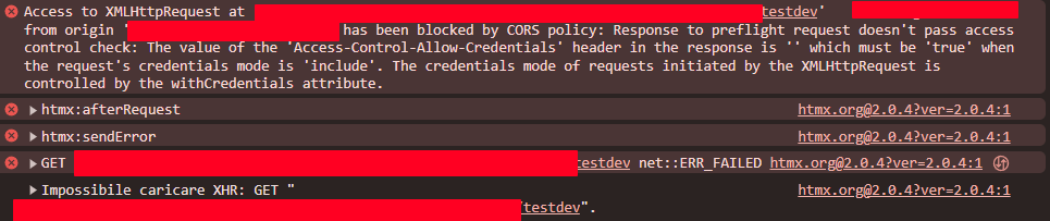

i need it for send credential from a htmx request
htmx.config.withCredentials defaults to false, allow cross-site Access-Control requests using credentials such as cookies, authorization headers or TLS client certificates

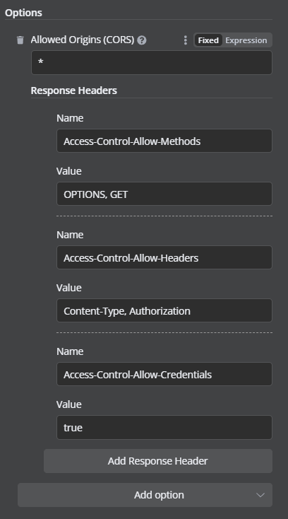

i see we can add options with the settings below and we can add custom headers but it seems not works :S
this is my configuration
i have try with respond immediatly or with the node but not works
Someone can help?

We don’t support OPTIONS in the webhook node as an option, I would expect your cors headers to only kick in if you were making a GET or PUT request, have you tried making a call with something like curl directly to see what is being sent?
If you do need the OPTIONS method then I would either create a feature requests for that or handle it outside of n8n like in your reverse proxy.

pratically htmx made a pre http request and i need to set OPTIONS if i want to set some security settings
