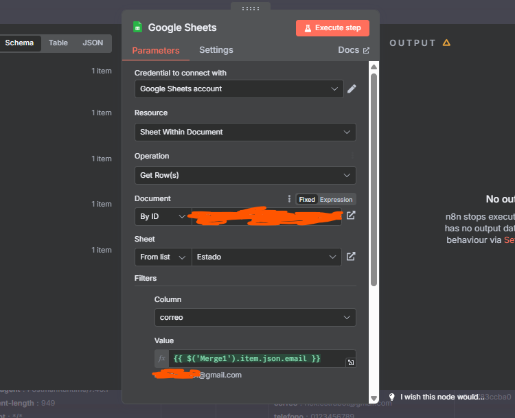

I have a Google Sheets node where I’m filtering data by email. Here’s what’s happening:
  • When the email exists: The filter returns data correctly
  • When the email does NOT exist: The filter returns nothing (empty array or undefined, i am not sure)

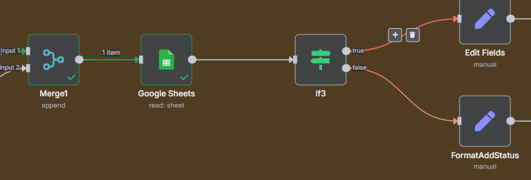

  • What I need: I need to use an IF node to route the workflow based on whether the email exists or not
What I’ve Tried
The problem is that when the filter returns no results, I can’t properly evaluate in the IF node whether the email is present or not.

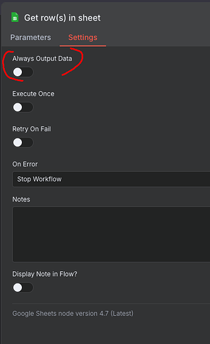

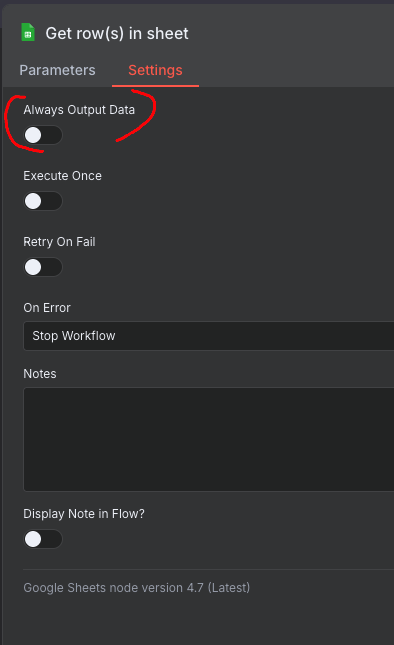

Hey @Ricardo_Robledo
What you have to do is go to the Google Sheets’ settings and enable “Always output data” option. This will make it produce an empty object instead of no result. This way in the if node you can check if the {{ $json }} object is empty.
