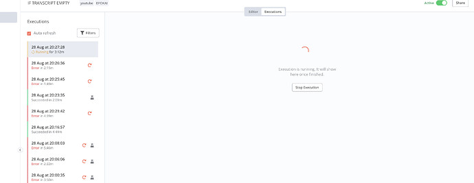

when i run my worflow i can see running in editor but if i close window and i come back, i cannot see in editor and neither in execution
there is a solution ?

manual if i leave the page, and active exectution

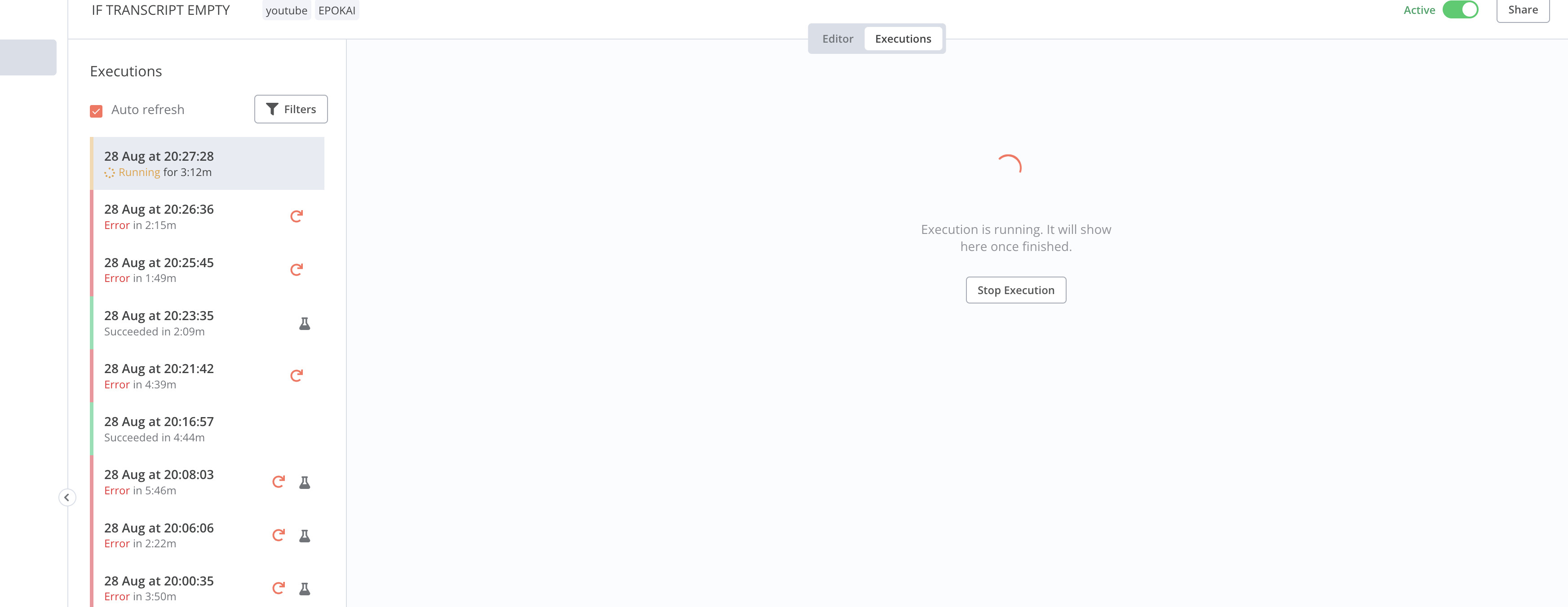

So if i go to editor there is nothing, and excution i have this
Thanks for the details. This is expected behaviour.
Active executions don’t show in the UI as they proceed. They will show once they complete, whether successfully or not.
Manual executions will also stop the UI running display if you leave the page.
This does not affect the performance of the workflow, it is purely visual.
