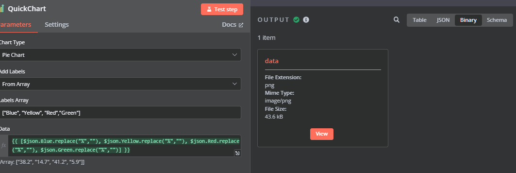

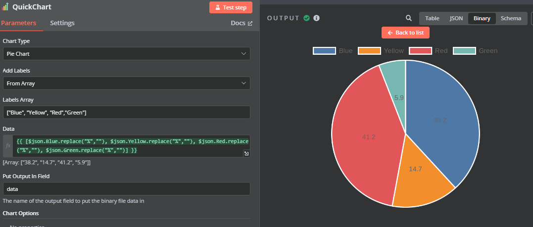

Currently I have got most of this workflow working, and I’ve been able to successfully generate a Pie Chart using QuickCharts tool, but I’m having trouble emailing it.

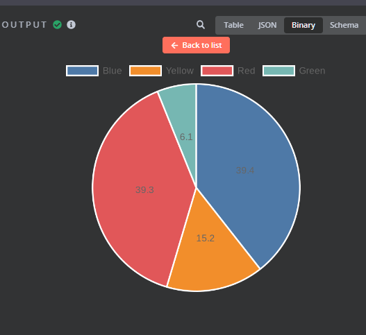

The Pie chart comes out like this
Does anyone have any advice? Should I be exploring another way to generate the pie chart so I can send it?

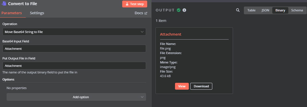

Simply put, it converts the attachment’s binary data into a downloadable file, allowing you to perform further operations, such as uploading it to an email…

To answer you question, the Output binary looks like this:
and when I click view, it looks like this
Am I converting into Base64, then back to File, so that it can be downloadable? I did notice it gives me this option after I try that.
Am I correct in assuming that I need to have this downloadable format and then I need to upload it onto Googledrive, so then I can use a Google Drive tool to attach it to the gmail?

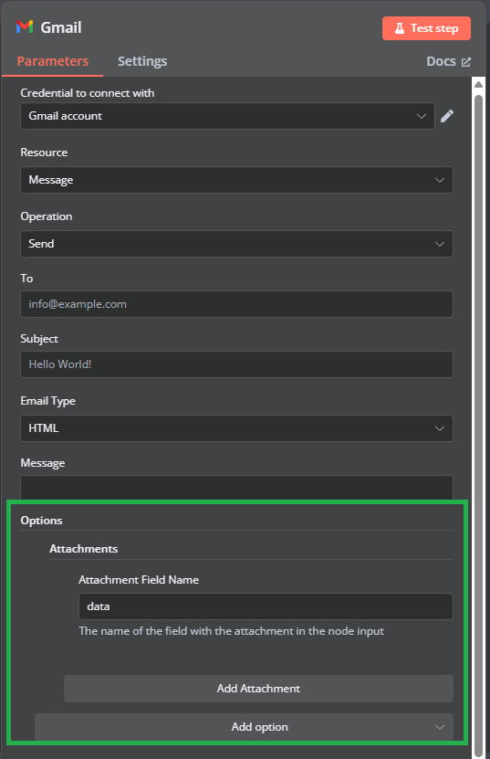

You do not need “Google drive” (this was an example) sorry for the confusion.
You can attach this file to the Gmail node directly

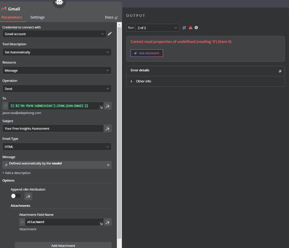

Workflow currently looks like this

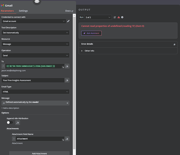

The error I’m currently getting is on the Gmail App, which currently looks like this
I’m not sure what I’m supposed to put in the attachment field name actually, nothing seems to be dragable/droppable into the field.
Hi, can you try this
I removed the second AI Agent and directly connected Gmail to send the email with the attachment, why do you need it in your workflow!?
Hey @mohamed3nan ,
Haha Turns out I was over complicating it.
I removed the email edit fields and code lines and just used the email taken from the first part of the survey, and now it works!
