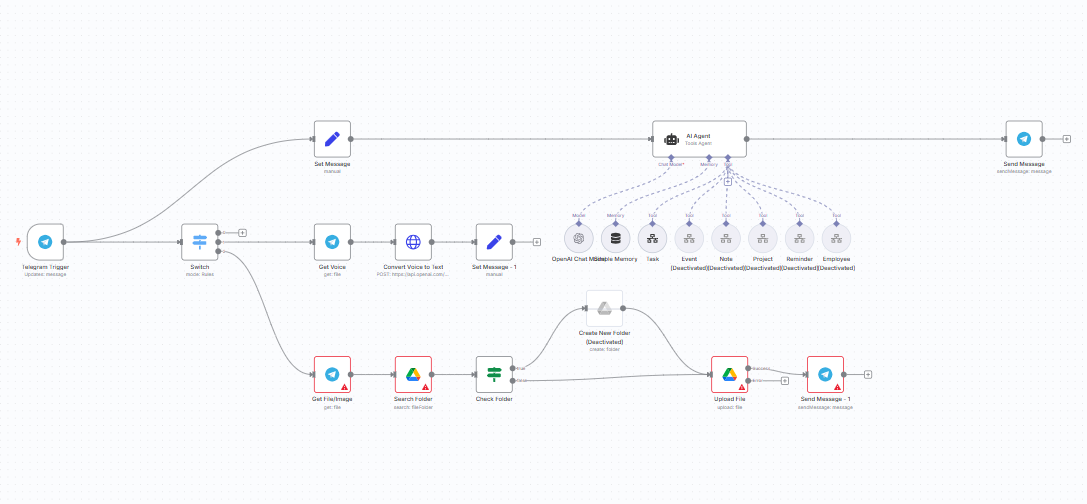

Telegram trigger doesn’t work
Hi, so you can’t trigger any webhook you created even from an outside tool?
Do you put them in active / or test mode?
I would recommend trying them with an external tool and make sure you use the right parameters
Also: an actual workflow instead of a screenshot would be.better
