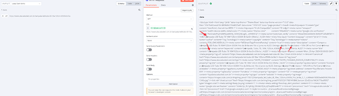

I am getting some special characters problem when doing a GET HTTP resquest to a URL.
For example: a GET to this URL: Lâmpada LED Tubo T8 18W 120cm 6500K Brilia Em Oferta | ALED
Is resulting in the characters problem below, I need them to be the right brazilian portuguese characters:

The HTTP Request node is reading the site’s content type as it is displayed. And the site’s encoding is in iso-8859-1, which is a bit old school. n8n uses UTF-8.
In order to convert the content type you’d need to install a library like iconv-lite and then add a Code Node to your workflow to convert the source code into UTF-8.
This will only work on a self-hosted environment, so good thing you’re already hosting :slight_smile:
If you want to go down that route, you can follow this article to help you set up the library.
This community post also has some useful info on importing a library to use in the Code Node
