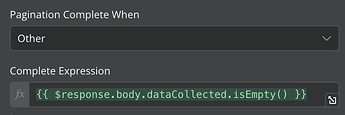

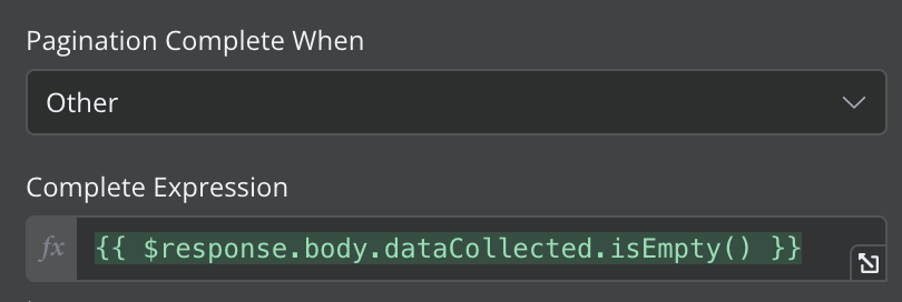

The output suggests that the response is not empty. You would need to adjust the Completion condition. Does dataCollected represent the expected data you are after? If so the Completion logic could be modified to become {{ $response.body.dataCollected.isEmpty() }}

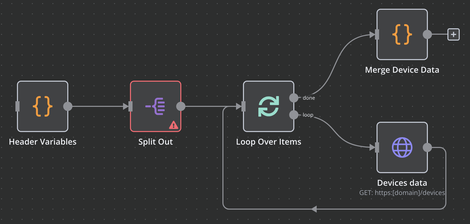

Here are a new piece of my workflow

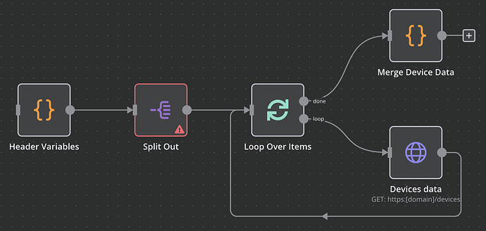

You would need to split your products with Split Out node and Loop the pagination through those products. Visually it will look something like this
If that happens then you’re likely doing something wrong. Error should not occur, you shouldn’t let it by utilizing the pagination technique properly.
Wow! It is almost done! However my pagination keeps not working
You need to check the error when HTTP Request node fails, it should give you a hint what is going wrong. Better yet, locate the API docs for the service you connect to and see what the pagination technique is used to figure out how to configure it correctly. Different APIs require different approach to get pagination working.
