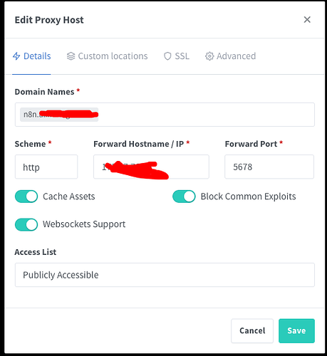

I cannot get n8n to work on my server. I got this websocket error message in console
I cannot get n8n to work on my server. I setup using nginx proxy manager and a docker swarm compose
From console log
WebSocket connection to 'wss://n8n.dev.mydomain.xyz/rest/push?pushRef=hvrtbju7i2' failed:
My docker compose

You don’t need :5678 if you use NPM you’ve probably already added it there.
Well I removed it. The main problem is still lying between npm and n8n wss websocket. What is the setup suppose to be?
In your NGINX Proxy Manager Settings does your n8n proxy host (n8n.dev.mydomain.xyz) ‘Advanced’ section have this:
proxy_set_header Upgrade $http_upgrade;
proxy_set_header Connection "Upgrade";
proxy_http_version 1.1;
proxy_set_header Host $host;
If not then add it and then Save and Restart NGINX Proxy Manager.

Doesn’t help.
I just remove nginx proxy manager and use traefik instead to avoid all these headace no solutions problem.
