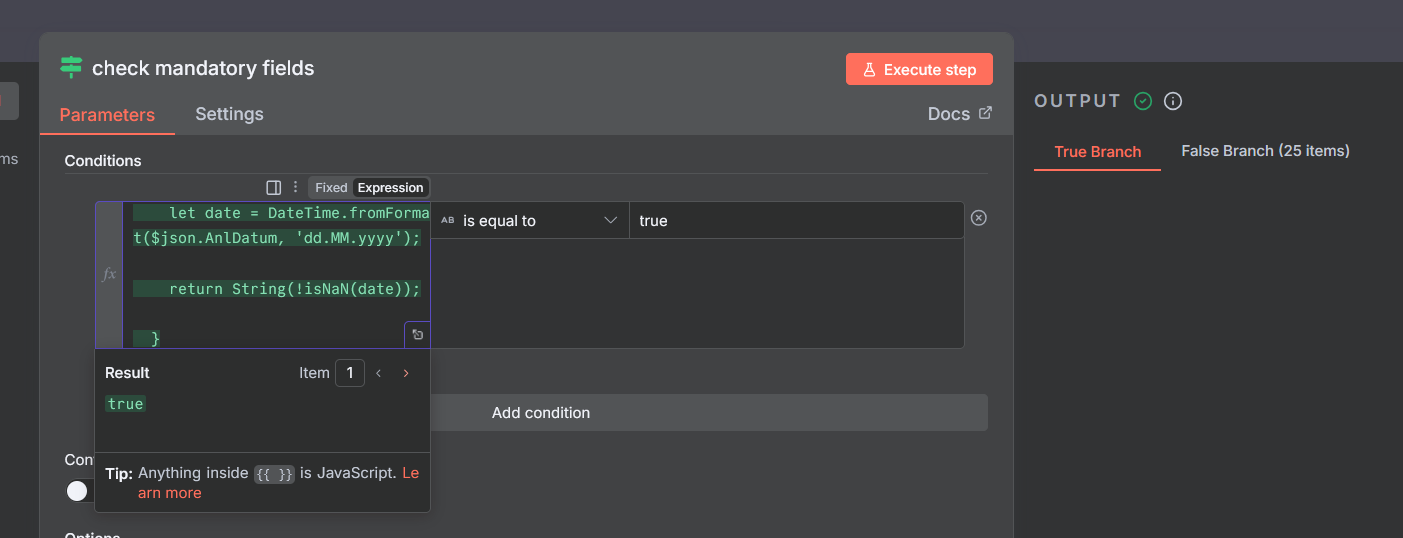

I want to check incoming items with an if node to sort out the ones containing wrong data. Two problems arise:

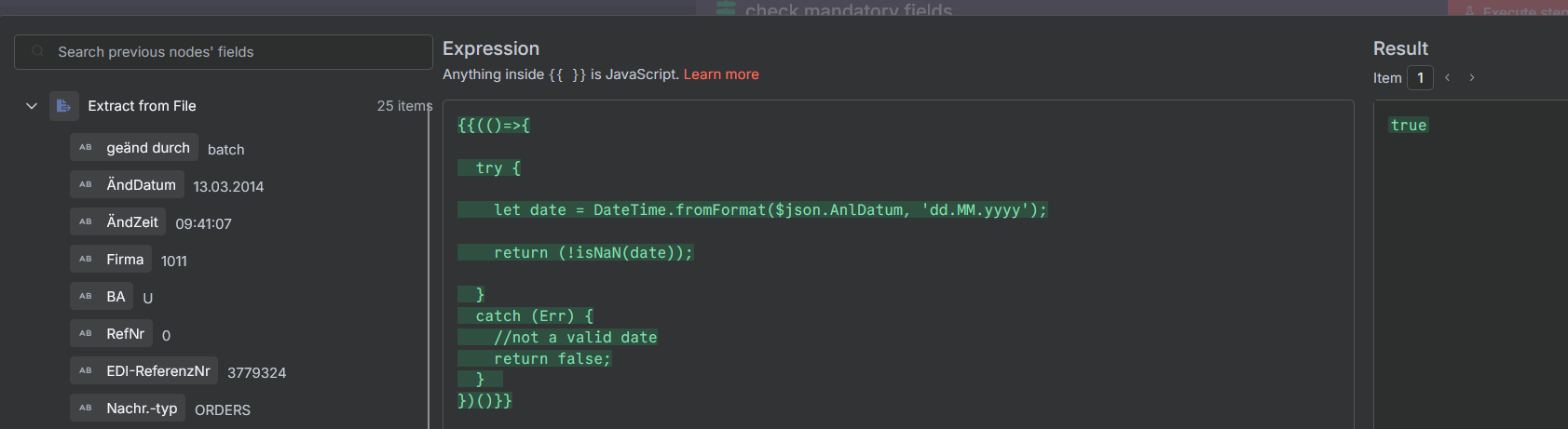

  1. while switching items in the expression editor I get true and false values back from the expression but when I execute the node only false ones appear
  2. I cannot create the return value of the expression with the right type. Neither does (!isNaN(date)) produce a boolean not does return false or return “false” produce a string - confusing
Item 0 returns false
Item 1 returns true
Output is all false??
Expected output would be 2 false and 23 true output items.

Please see if this helps:
Well, thank you jabbson, that does work like a charm but why isn’t mine?
I just looked at it and was like - nope, I am not digging into that, let me rewrite :slight_smile:
I understand that but I would like to get an idea how the IIFE syntax resolves return values because I think that’s where the problem with my approach and I won’t be able to solve everything with one statement :slight_smile:
In case you need to do code, just do code - make it simple, readable and reusable:
