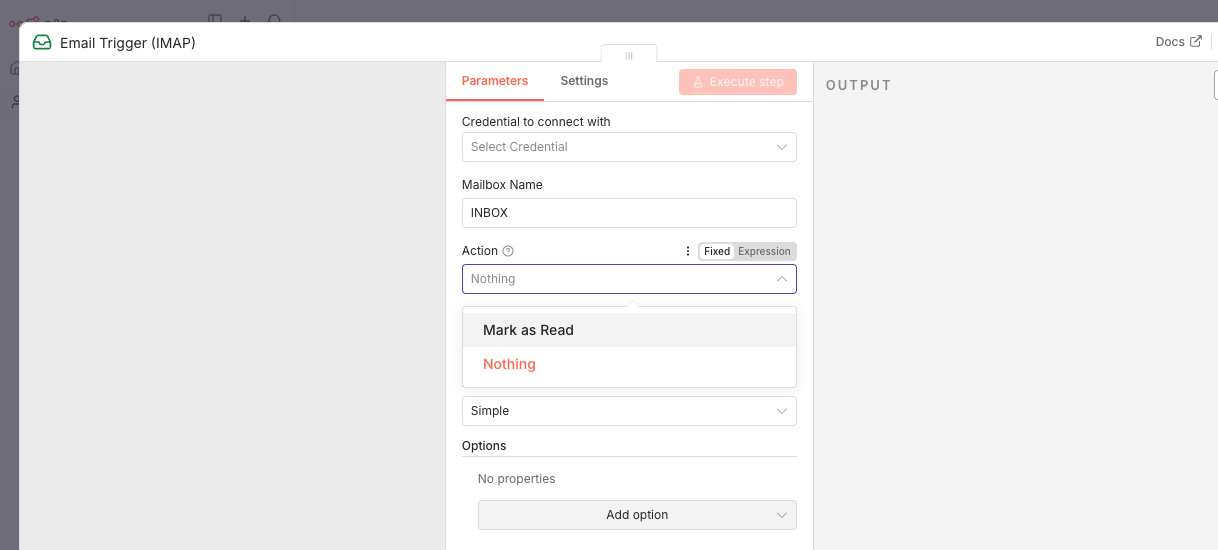

just to make sure:
you tried to set ‘nothing’ here as the action instead of ‘mark as read’?

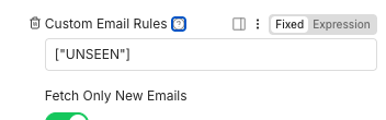

But what happens if you set Action to Mark as Read and also used the custom email rules to filter?
Are then all emails as read? also the ones that didnt passed the filter?
